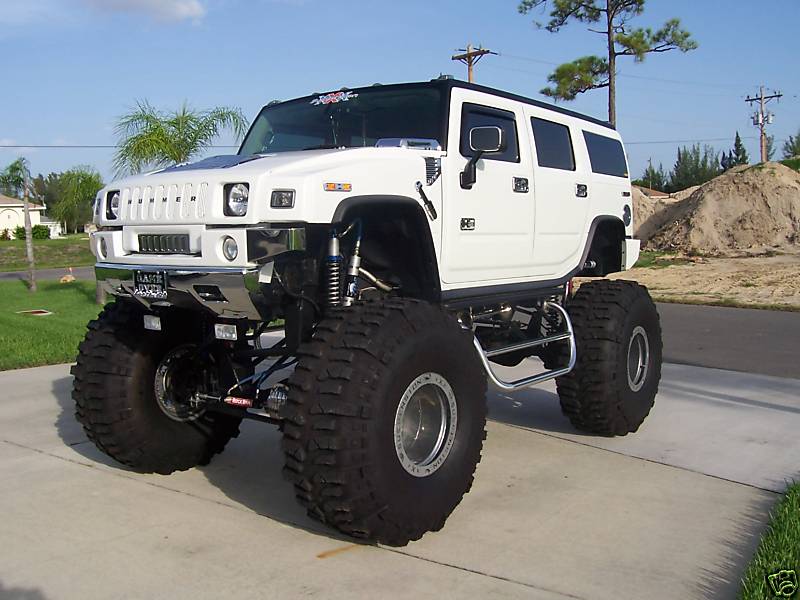

Is there any.
I ?ve seen one made but it was completely custom job.
This truck seems to have small body lift

This hummer got one for sure check the gap beetween body and frame...

solid front axle .....
