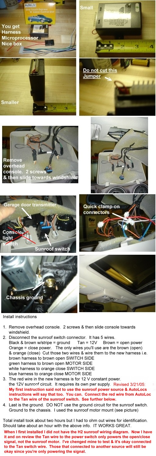

I've noticed some interest in the express sunroof on some of the newer H2 for '03's. Here's a link to a product that may work if any are interested.
http://www.autoloc.com/detail.lasso?itemid=WC1000 Talk to Tom @ ext 312
Got it today, installed & works GREAT! One touch & it opens all the way. One touch & it closes. One more touch & it tilts open. Just touch anywhere while it's traveling & it stops there. Great upgrade for only $40 bucks plus shipping. Here's pics & some hints to shorten install time. Oh I need to add to the install instructions the processor is small enough to just lay inside the overhead console. Enough foam it won't rattle. <span class="ev_code_RED">My H2 is an '03. Confirm the wiring in your H2 is the same before making connections.</span>

So vette & tim. Just in case I decide to try this mod, one touch closes the roof and if you touch it again it does the tilt open?? I'm pretty sure the product I found will work for open/close but just wondering about the tilt open part with express.

Checked with AutoLoc this morning. They talked with their tech support and assure me this will work with our sunroofs. Also, the little processor is only about 1" thick so hopefully it will fit inside the roof console making a very easy install. I ordered one and will post the results with install info later this week.

Got it & installed. See 1st post above for pics/install. Works GREAT!
