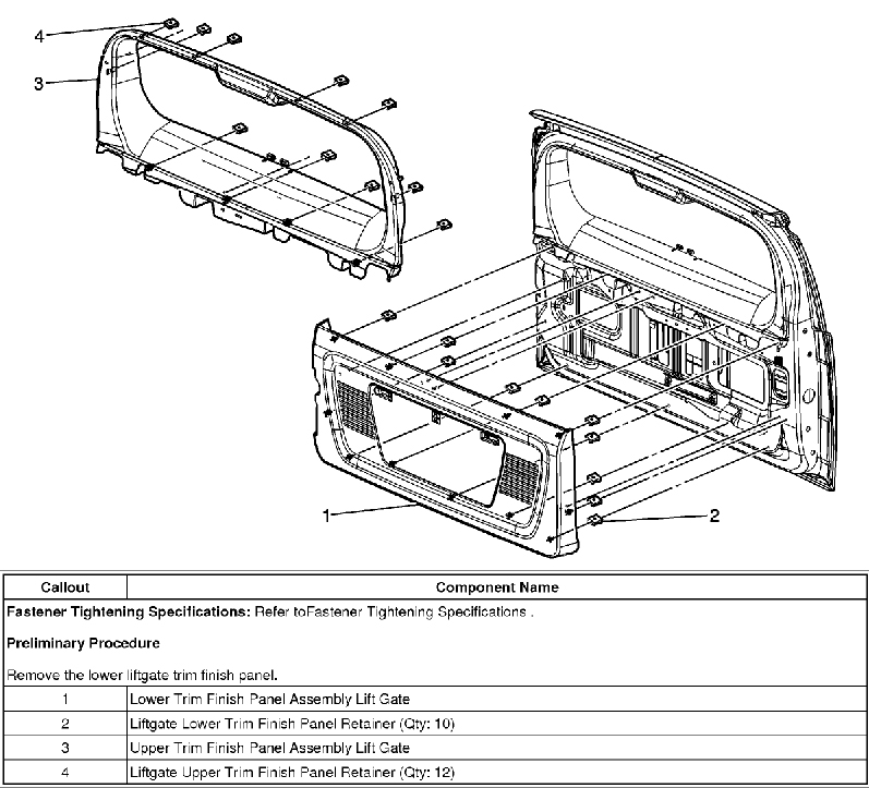

Please help me with removing the tailgate inner panel specially the upper one were the stop light is.

Thanks Bro but it seems that this information never been out on the net, any way i tyred to do it my self , this is how :
1st remove the lower panel usually black by pulling it from the corners.
2nd you will find the upper panel is attached to the door frame with 4 black retainers which you can easily pull out but the problem is with the 4 metal clips that are holding the panel from the top they are difficult to remove i tyred to remove one and broke it

I find these pry bars work well under panel clips,I picked up a set last year and used them a couple times and I havent broke a clip yet.
LINK http://www.harborfreightusa.com/usa/itemdisplay/displayItem.do?itemid=95214&CategoryName=&SubCateg oryName=

I allways use those to pry panels but the clips were held firmly and i used a little of force
