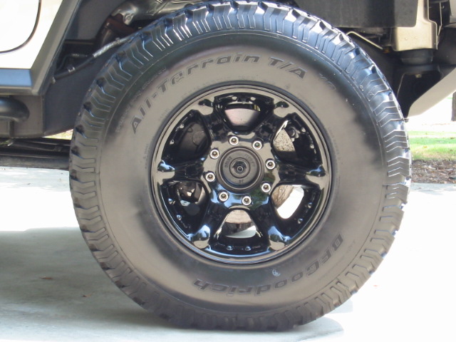

I spoke with one of our powdercoating subs today and got some info for all of you that are thinking about PC'ing your wheels.
BK-01 is a black PC that will give you a texture that is similiar(maybe a little smoother) to the factory brush guard. Very durable.
BK-05 is the semi-gloss matte finish that I've used on two sets of my wheels. It's not a dull matte finish, but it's also not a high gloss either. Like Goldy Locks would say "It's just right".
BK-08 is slightly more of a matte finish than the 05, but it's much more durable. I'll be using this one when I redo my set of wheels that got chewed up.
Hope this helps.

Whoever said you had to beadblast is selling you an extra service unless you're starting with a wheel that already has a finish on it. I started with just polished wheels, we "cleaned" the little dust that was on the new wheels off of them, and then powdercoated... 12,000 miles later, there are absolutely no problems and that's on and off road.....including a lot of mountain gravel roads.....

Sorry, but you're wasting money on some wheels because they are not all coated.......and if your powdercoater is worth his salt, he'll tell you that.......
I've done a lot of powdercoating for a show car's engine compartment in the past as well, and we never blasted anything that was not coated, only cleaned the part. Never a problem!
Spend your money if you want but I would ask some other powdercoaters their experience....
