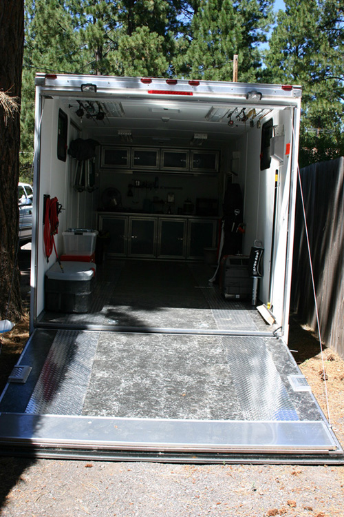

08-08-2007, 10:08 PM
Posts: 1,216
Re: Towing H3 behind motorhome?
Any more questions for the master?????
you sir have a question???
Here to help
What do ya think??........Maybe Just-----take the Garage???
08-09-2007, 06:10 PM
Now that is A+ my friend, beer in that cooler there.....
