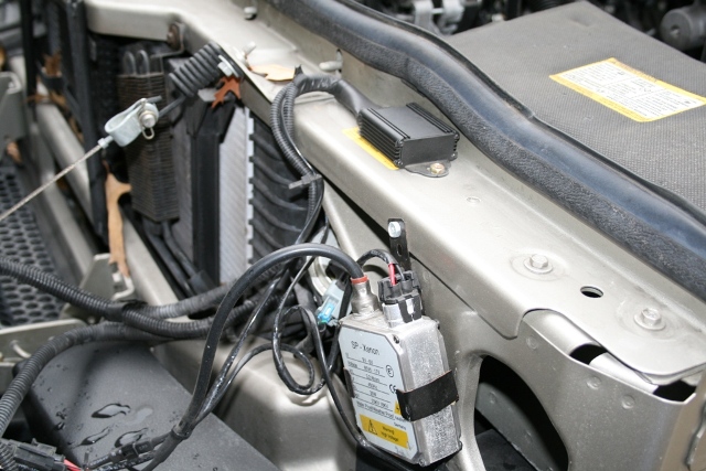

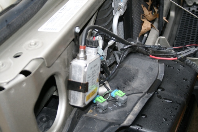

I'll take a pic of my set up this morning after I wake up!

Old 01-18-2009, 06:33 PM
porschett's Avatar
Join Date: Oct 2007
Location: Sarasota
Posts: 346
Default Re: 55 Watt HID kits
Here's the pics

Old 01-19-2009, 12:12 AM
RippSpeed RippSpeed is offline
Join Date: Oct 2007
Location: Rowland Heights, California
Posts: 227
RippSpeed is on a distinguished road
Originally Posted by porschett
Here's the pics
thanx for the pics bro ... I always wondered with the hood close would we have enough room there...
but where did you tie in the ground cable ??? Did you ground them at the horns ????

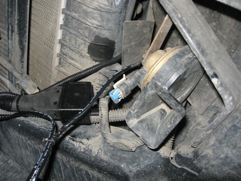

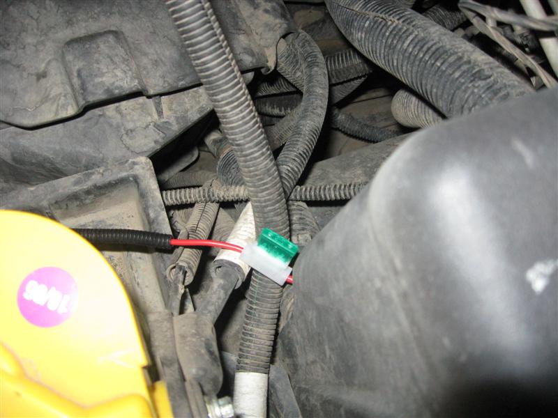

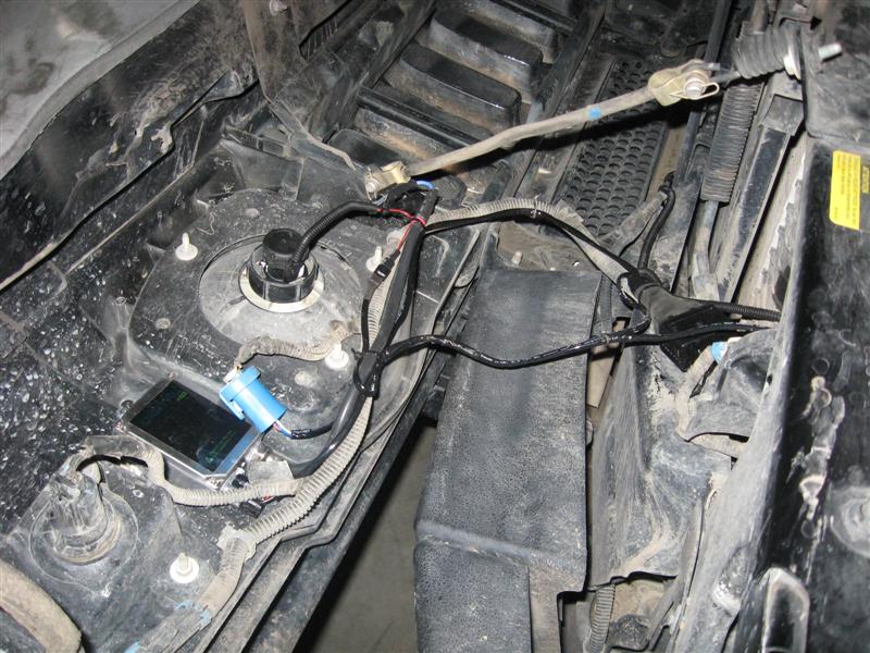

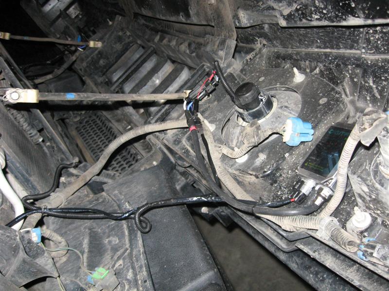

Old 01-19-2009, 07:27 AM
dochummer's Avatar
Location: Eastern Washington
Posts: 2,453
Here you go. I grounded mine to the horn mounts on both driver and passenger sides . Hey, it works. I checked with a meter and they work fine. The Ballasts were mounted with some shorter screws that I had on my bench, and fit perfectly next to the headlamps. The relay was just zip-tied to the wires coming through next to the horn. I then tapped the power from the post under the fuse box cover. I left the original plugs close to the headlamps so I can swap back easily if I need to.
Overall, a lot brighter than the silverstars I had. The light isn't as "smooth" as with my wife's vehicle (stock HID's). It seems there are some darker spots than others. Most likely just the reflector not spreading it as well... She was driving it tonight and noted that 2 or 3 people flashed their brights at her so I've gotta re-aim them also...

Old 01-19-2009, 03:23 PM
porschett's Avatar
Join Date: Oct 2007
Location: Sarasota
Posts: 346
I came off the lights with a 10 gauge wire and ran it to the alternator mounting bracket. No better ground than that !!
