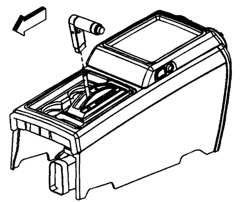

Hi,
I just got my AV system installed. I took apart all of the door panels and center console to check the quality of the installation. I noticed that the rear AC vents are connected to a single duct that leads into the center console around the shifter area. Is there supposed to be another duct that was connected to the front AC ducts? I'm noticing that no matter how high I set the speed of the AC, there is not a slight presence of the AC coming out of the rear vents. Anyway can help me check if there is in fact ducting connecting theo back to the front? My installer might have forgot to put it back along with several screws and broken clips.

<BLOCKQUOTE class="ip-ubbcode-quote"><div class="ip-ubbcode-quote-title">quote:</div><div class="ip-ubbcode-quote-content">Originally posted by Speedracing:
Is there supposed to be another duct that was connected to the front AC ducts? </div></BLOCKQUOTE>
From the '05 service manual (page 8-458), when installing the console: "Important: Make sure HVAC duct is aligned with center console."
I haven't had the console off but my guess is, in the picture below that's a duct end sticking out of the console.

Thanks guys.
The diagram from the Manual really helped. I now know that the installer took off the duct and left it out to make room for the Kenwood Brain Unit. This sucks. I'm going to have them get a new one from the dealer and reinstall the system. These guys don't even know what they are doing. I'm so mad for paying thousands of dollars for a system. They didn't even use the original Diamond Audio Hex crossover modules. They just soldered in a cap to cut off the low frequencies to the tweeter. How mickey mouse work this is.

Are you sure they left the duct out?
You would be getting a lot of air blown down into the interior of the console.
The duct work has 2 connections. 1) At the front of the console on the driver's side. The duct is sort of rectangular with the long side on the vertical. It runs along the driver's side of the console under the shifter and the storage compartment. 2) Right there it has a second connection and that is the one that can be easily disconnected with the console put back together.
I can't imagine them removing any duct work to save room due to how it runs through the console since there would be better options, I would think.

According to Rodster's diagram from the service manual, I'm absolutely sure they left the duct out. All the air is being blown into the interior of the center console. I can feel the AC coming off the gaps of my gear selector.
When I removed the center console, I noticed that the rear AC vents were connected by this Y-shaped duct. But they were not connected to anything else. These installers didn't know what they were doing.
