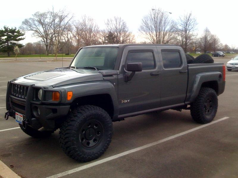

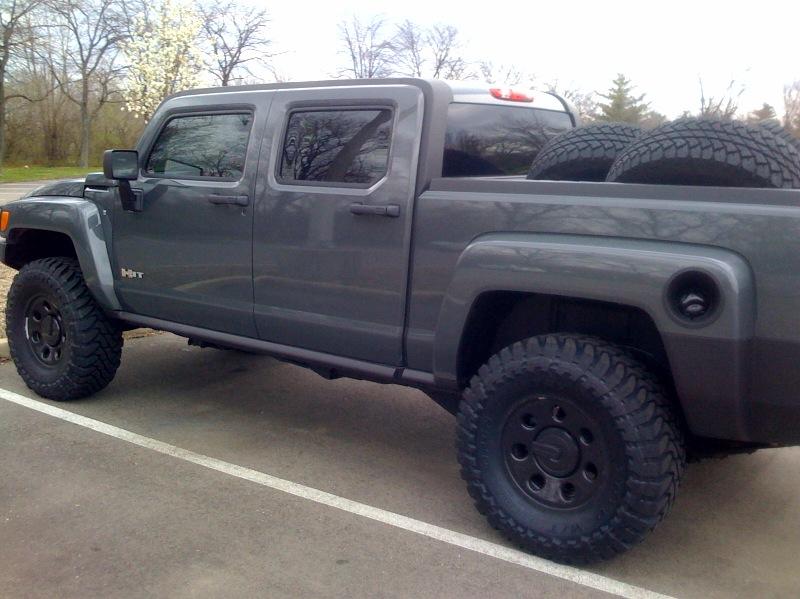

Default Got them 35's on!!!
Finally got em on. Just some quick iphone pics. What do you think?

That... is... beautiful!
First H3T I've seen with aggressive 35's, and just as I expected, the truck FINALLY looks like it's supposed to!
Congrats, you've got the best looking H3T I've seen!

I would like to see close up of tire. What kind of tires and what size are they? Oh' and they look very nice!!

They look great, give your ride a meaner more aggressive look!

Sweet Terry!! I saw this on CHO and didn't realize it was yours. The truck looks great!! IMHO leveling and slapping 35's on is a must for the H3T.

Thanks...just to let everyone know i went with the Trailduty Bilstein shock Leveling kit with bump stops to level it out. That kit cost $209. The tires were about $277 a piece. I had the dealership do the work since i wanted it done right...that cost me approx $400. I sold my old tires for $450. \
I'm happy with it!

got the kit from trailduty.com. cranked the torsion bar in the front and the shocks are just better/longer shocks to use now that you raised the front end. The tires are Toyo Open Country(tire discounters) 315/75/16.
Have recently just had the PCM/TCM tuned by PCMforless.com. they are amazing! The truck now has it's power back. This is a must for I-5's who want to put 35's on!
