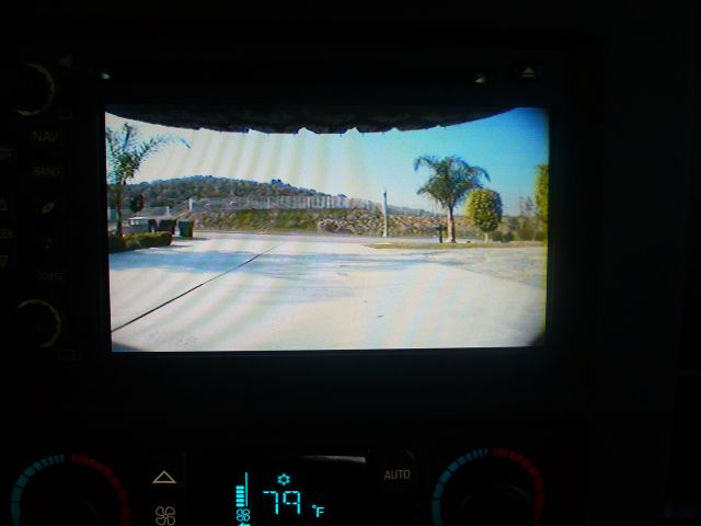

Rear Camera
2006 H2 SUV, Slate Blue.
Old 12-13-2005, 06:38 PM
Jesse Jesse is offline
Posts: 59
Jesse is off the scale
Rear Camera on screen

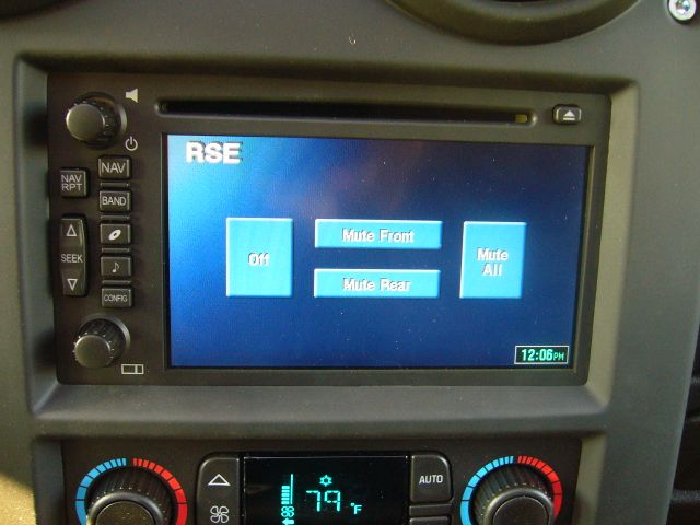

Rear Seat Entertainment Audio Input - with SPEC-USA piece

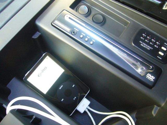

Ipod Hookup - Notice the IPOD even shows the Axxess Logo - so you know it is hooked up!

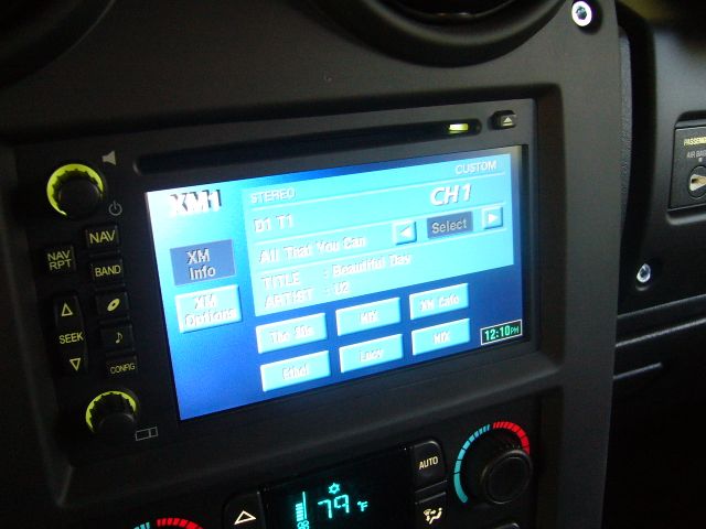

Ipod On screen - notice it shows Album, Artist and Song Title!

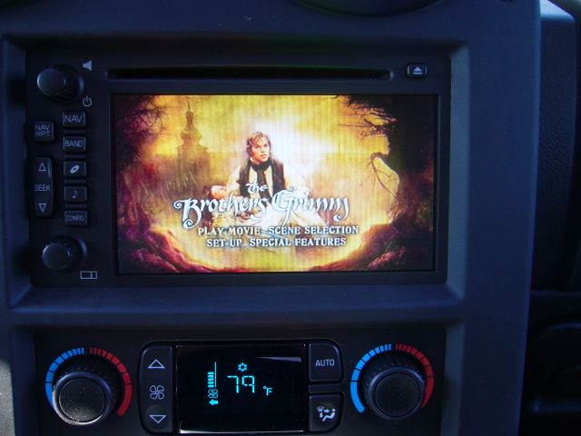

DVD Movie playing to the screen - no more FM Modulation either - just push the CD button on the head unit and it goes to the dvd audio.

The screen shots may look grainy or like is some distortion coming through. This is just that it is very difficult to take a picture of the screen without getting that affect. I can assure you that all the screens are crystal clear. The dvd on the screen looks amazing.

What are the two buttons inside your console?
Can you play the DVD in the back and still listen to an alternate source up front?
Do you have a switch to turn on the rear camera at any time? (Is it one os the switches I asked about?)

The switch with a light allows me to turn on the front screen. Basically switching it away from the factory screens turning it into a video screen. The 2nd switch is a 3 way switch - one position is for rear camera (the default position), the 2nd position is for DVD input (also switches to the audio on the dvd), and the 3rd position is for my AUX3 input on my rear system. This will be for xbox hookup of whatever I want to put on the AUX3 input. This switch also switches to the audio on AUX3
Even though the audio is being switched - it does not necessarily mean it is being played over the factory system. To get the audio to come through – I need to push the “CD” button on my factory system to get to the Rear Seat Entertainment sound.
This means that I can listen to any input – XM, FM, AM, Ipod and change to see what is being played on the dvd or xbox without changing the audio. If I want to hear what is being played on there I change the input to CD.
This is the part that of the install job that I needed help with. I found a great installer at an Al&Ed’s Autosound shop here in southern California. They are the ones that helped me get the relays and switches all figured out.
