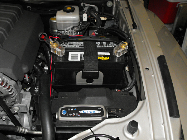

I had the same problem with my H2 and it's even worse with my H3. After trying different batteries and cables I installed a CTEK charger. I have it plugged in whenever I'm not driving it. It works great, no more problems!
