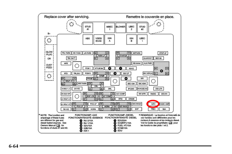

Old 02-26-2005, 11:52 PM

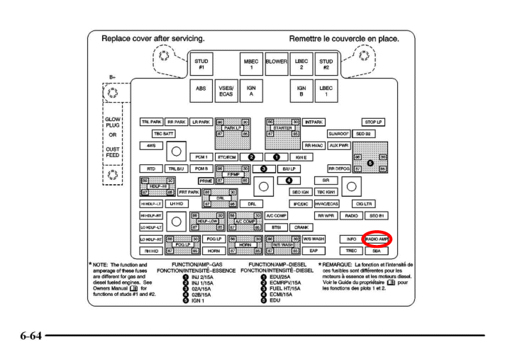

There is a fuse in the fuse box under the hood that says radio amp. It is next to the blinking red circle in this pic

Old 02-26-2005, 11:56 PM
Sorry, I guess I should have made one with the circle blinking around the radio amp fuse. Maybe this will redeem my laziness.

okay checked amp fuse was ok can an amp go bad jut like that. will have to take it to the dealer on monday to get fixed. unless any one else has ideas.
