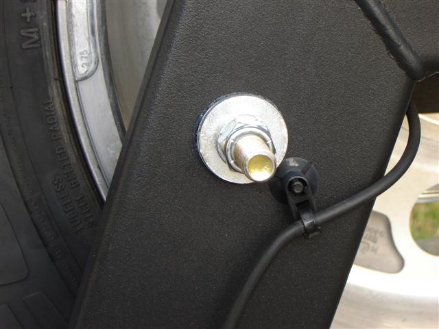

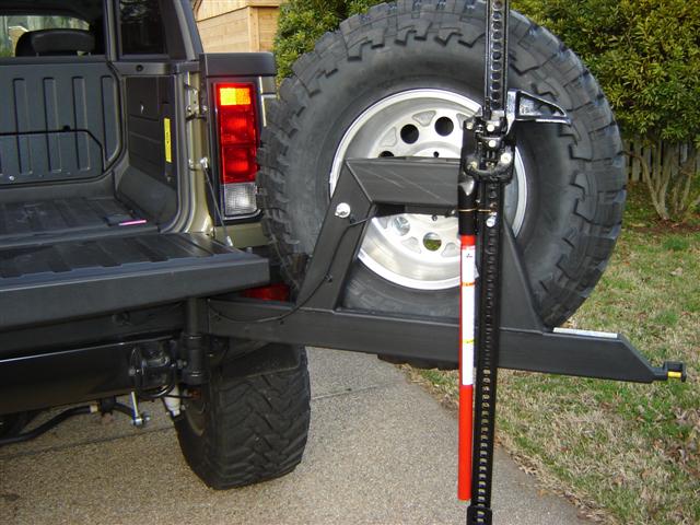

I couldn't firgure out a good place or method for locating the HiLift, so I bolted it on.
I used two, 3"x 1/2" grade 8 bolts with shoulders, lock washers and Nylock nuts.
Old 01-20-2006, 10:52 PM
Old 01-20-2006, 10:54 PM
Drilled a 1/2" hole all the way through the carrier and attached the bolts as seen in the pic above.
I then mounted the HiLift on the bolts and used one Nylock nut on one side. I didn't tighten it all the way.
When it's time to go wheeling I'll just pull the Nylock and replace it with another wingnut.

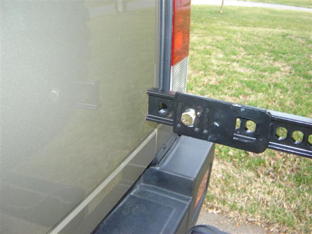

Old 01-20-2006, 10:56 PM
On the otherside I used a wingnut.
The problem with mounting the jack back here is you will hit the tailgate when you lower it.
Old 01-20-2006, 10:57 PM
So now if I open the tailgate, I remove the wingnut and swing the jack down out of the way.
Old 01-20-2006, 10:58 PM

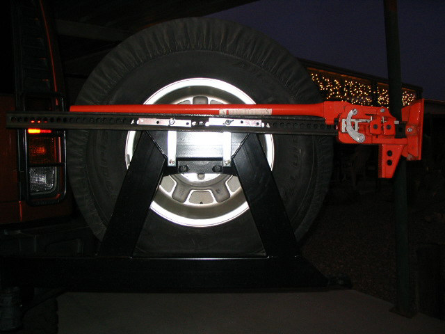

Piece of cake.
Finished product.
Old 01-20-2006, 10:59 PM
One last thing, the bolt holes MUST be precise. You can't bend anything to fit. I found out the hard way.

Nice work, <STRIKE>Macgyver</STRIKE> Ken. Very clever design!
\'05 SUT
Old 01-21-2006, 12:27 AM

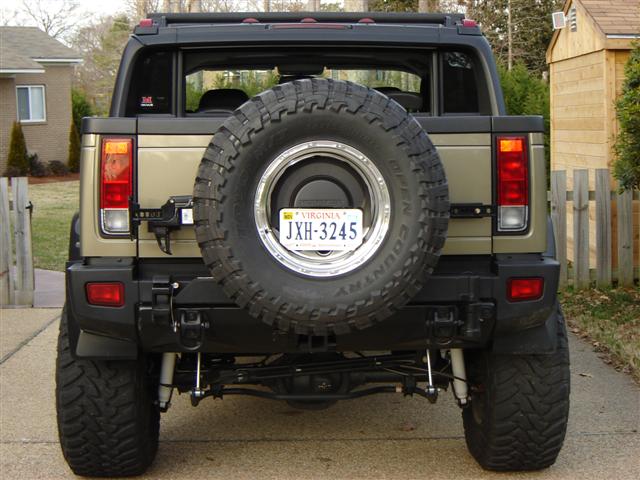

I wanted the 60", but I'd have nowhere to put that monster.
I was going to mount mine like yours, but the tire is in the way. That is going to change, I promise that.
I like the little padlocks. Instead I ran a 3ft cable lock around the back of the tire carrier and through a couple of jack holes.
For drilling through the metal I used a Black and Decker brad point 1/2" bit on a cordless drill. I couldn't believe the cordless worked better than the air drill. Must be a torque thing because the cordless went through it like butta'.

Here is a link from Az Hog on mounting a Hi-Lift Jack on a SMA Tire Carrier, it will work for H1 & H2.
the web site is www.azhog.com
Look under Hummer Technical Information, and then look for Hi-Lift Jack Mounting for SMA Tire Carrier for H1 & H2.
I did the mount on my H2 and the cost for parts was right at $20.00

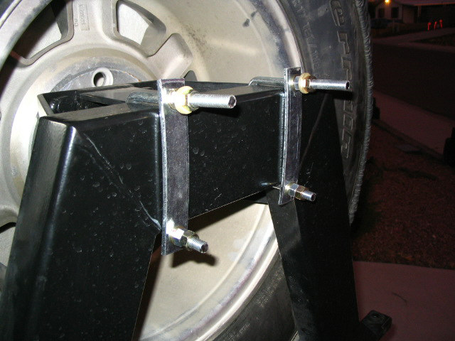

Old 01-21-2006, 02:01 AM
Arizona Hummerboy's Avatar
Location: Phoenix Arizona
Posts: 745

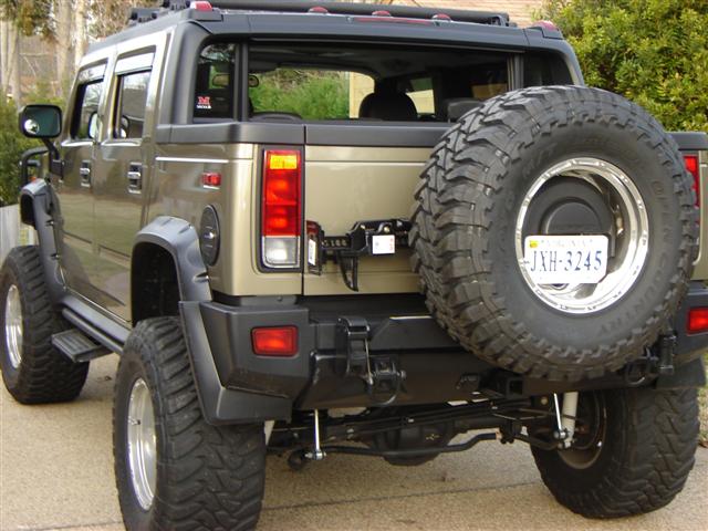

Here is another picture of the Jack Mounting.
