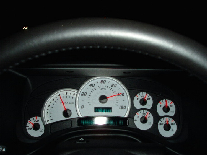

I'd say I was moving pretty fast, and all was still quite.
