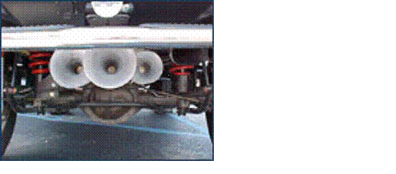

How about here....

peyton....
question for you... that horn you have mounted wouldnt happen to to be an airchime nathan horn...
as horn fan and owner of a nathan K-5-H i have an eye for these things... I would also add that mounting a nathan horn on your automobile is a federal offense and carries a hefty fine
BE CAREFUL!!!

I have no idea who makes the horn, it is mounted on a H2 that a local shop in ft lauderdale built. It is pretty nasty.

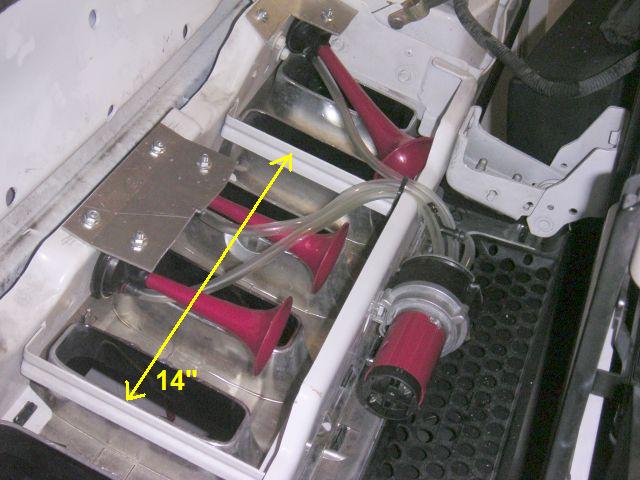

My air horns are not at large as your 12" trumpets, but I also was concerned about a good place to mount them. I found a useful area just behind the grill. I just fashioned an aluminum bracket to mount the horns in that area. It isn't pretty, but it does the job.
I just measured the distance between the vertical supports there and saw that it is 14" wide. You might be able to get those 12" trumpets in this area.
Also, if you can, try to get a slight downward tilt to the airhorn, to aid in water draining out, if it gets in there.
Good luck.

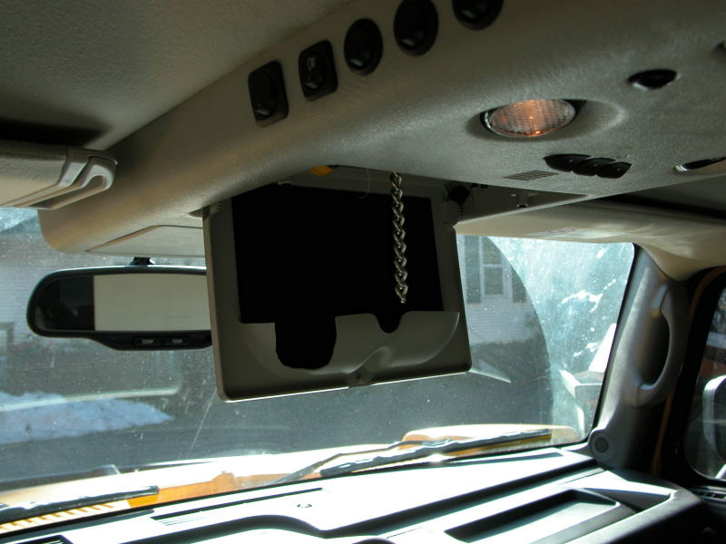

you want the the immediate availablilty of the horns power, the real trucker feel, and control of the volume of the horn... i have one word for all of you
LANYARD!!!!
