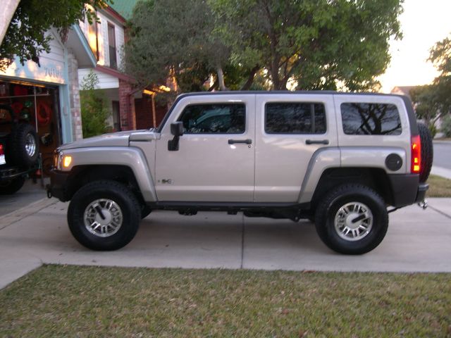

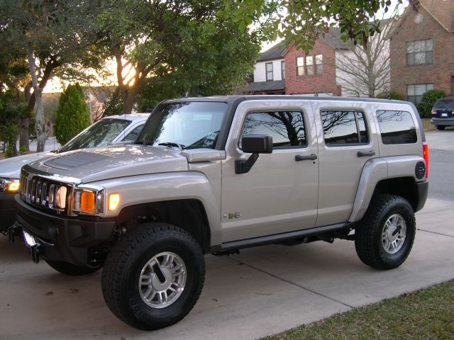

Has anyone else tweeked their torsion bars? 2 1/2 turns is about a little less than 1 inch for being even on my H3.
2006 H3, Torsion bar tweek and 285/75r 16 Bridgestone REVO tires
Old 01-14-2006, 01:58 PM
Hummie3 Hummie3 is offline
Location: San Antonio, Texas
Posts: 35
Hummie3 is off the scale
Angle veiw

Nice looking truck. I tend to like them pretty simple. I wish I had taken a little more time to decide before I had them put the chrome gas door on mine. That black one looks much better. Wanna trade?
