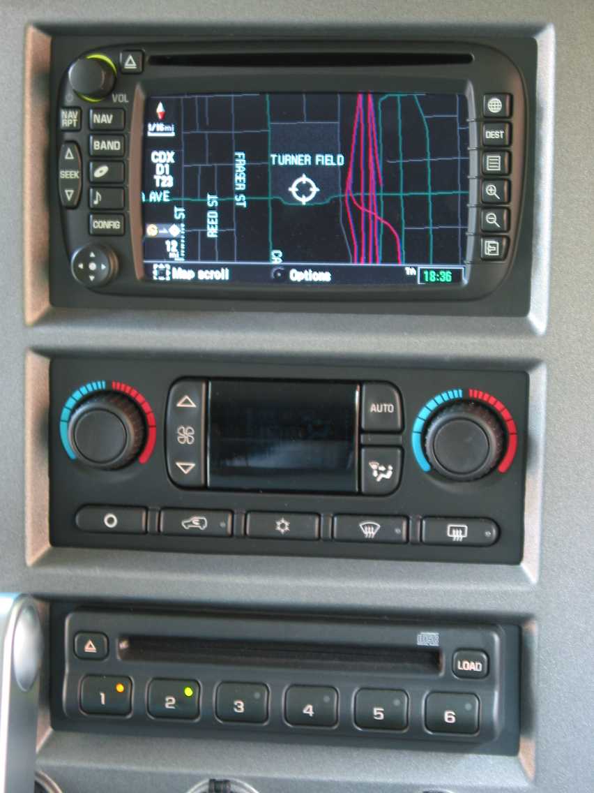

Another chance to post my changer pic!
I junked the OnStar and wired in the Escalade's external CD player in its place. I can now play CDs while the NAV is active.
In the picture, notice "CDX D1 T23" is displayed on the NAV screen. The changer is controlled by the NAV unit and the steering wheel controls, and it works perfectly.

You could mount the GM Changer I have under the seat, and use an extended cable to connect it. I'm not sure if it would play OK if mounted vertically, so you are on your own for testing that.
There are aftermarket adapters that allow you to use other brands of changers, but they have a checkered history of problems. If you do a search on this site for Soundgate or PAC you will come up with a lot of info.
I prefer to stick with GM parts if I can. So far, no compatibility problems doing it my way.
