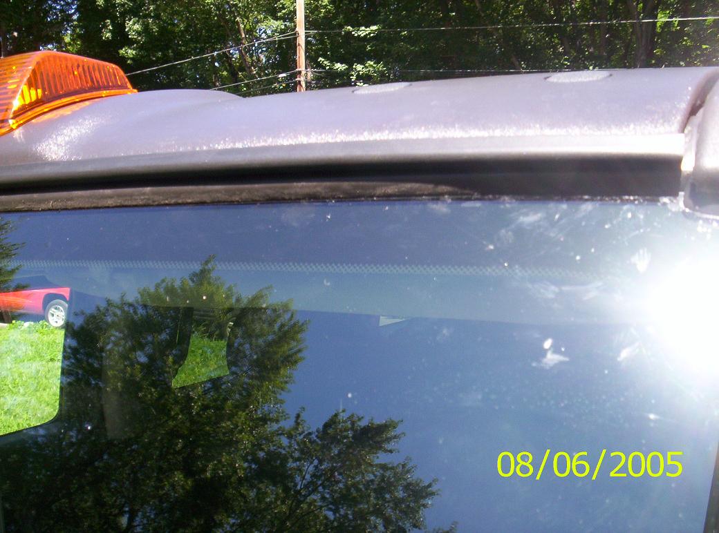

Mine where making a whistle noise. Today I had the dealer check them and they installed sticky foam tape under the front. They told me that this has been fixing the issue. I am anxious now to see if it made any difference.

I've had mine 2 months, paid dealer 585.00 installed. No noise till last week. I need to get up to about 60mph before it starts acting up, almost like bee's buzzing at top of windshield. When it's very windy, or around semi truck turbulance, it gets more pronounced. Dealer states they will fix on Wednesday by inserting foam tape and resealing; he says that has worked in the past. I kind of wonder though, as some have said the screws are too long. (service guy says no) if the screws were not too long, how would air get under the marker lights in the first place? There would be a tight seal, air would not get under and there would not be a buzzing noise. I will let you know after they are "fixed"

Mine where making a whistle noise. Today I had the dealer check them and they installed sticky foam tape under the front. They told me that this has been fixing the issue. I am anxious now to see if it made any difference. </div></BLOCKQUOTE>
Rick,I installed a piece of plain edge molding on the front of my marker lights take a look.

<BLOCKQUOTE class="ip-ubbcode-quote"><div class="ip-ubbcode-quote-title">quote:</div><div class="ip-ubbcode-quote-content">Originally posted by richk:
Did the edge molding make a difference? </div></BLOCKQUOTE>
Yes made big difference.
