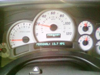

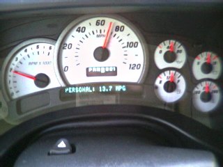

Fubar,
I can't give you any info about the Xtremeflow muffler nor about their claims of hp/mpg gains. You may or may not see noticeable improvements in hp/mpg; it really is vehicle specific.
Corsa is the ONLY GM licensed after market exhaust and can not be used as an excuse by GM to void your warranty.
After ALL the mods that I installed, I saw about 1 MPG gain. The truck gets driven about 80 miles per day - a combination of Hwy and stop/go traffic. It use to average between 12.5 and 13 mpg on a tank of gas. It now gets between 13.5 and 14 mpg per tank. However, the mpg gains will never justify the cost of the mods. I did them because I wanted to.
Yellow 03 Adventure w/black Grill, UM8 Touch Screen Navigation Radio, U2K XM Digital Radio, Remote 6-CD Changer, JBA Titanium Headers, Corsa Off-Road Sport, Airaid Filter & MIT, Nology Wires & Plugs, S&P Pro-Flash, Warn 9.5ti w/X-Line, Toyo Open Country M/T 37x13.5.

MPG #'s Mild Atlanta Traffic

Moderate Atlanta traffic

Bevo,
Thank you for taking the time to grab a camera then the additional effort of posting. I appreicate it. I am getting about 12mpg right now regardless of how I drive. Well so long as I keep it under 100 and out of the 4000rpm range. Since I just spent over 3 grand for the extended warranty I guess I'll go with the Corsa. The last thing I need is to have the warranty voided. I think it is also one of the only systems to replace the exhaust pipes with ones that don't hang 2 inches below that of stock. I don't know if the truck will ever see large bolders going under it but just in case I don't want to leave part of the exhaust system on the trail.
