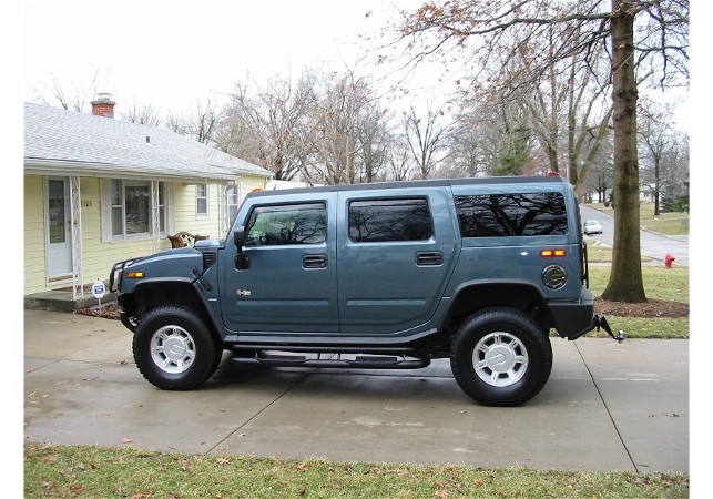

Old 02-28-2005, 06:16 PM
dochummer's Avatar
Location: Eastern Washington
Posts: 2,453
Did you have your air suspension engaged when you took this pic? Mine definately doesn't sit like that. Hmmm....now I just gotta get the dealership to make the adjustment

Doc,
No air ride, basic. I thought this was normal?

Old 02-28-2005, 08:08 PM
dochummer's Avatar
Posts: 2,453
A lot of the vehicles will "squat" a little in the back. I like your look better, mine definately squats more than I would like. Just have to convince the local dealer that it's not normal.

Old 02-28-2005, 09:40 PM
Doc, most stock H2s come with a slight rake to it (front lower than the back). Tell your service guy that your Z-height is off and that it needs adjustment.
So you know it's not your eyes playing tricks on you a simple thing to do is to just take a tape measure and measure the gap between the fender lip and the top of the tire and see what the difference is front to back.
Old 03-01-2005, 04:23 AM
dochummer's Avatar
Posts: 2,453
Ok, i'll do that... how long does it usually take to adjust?

Doc, I had "squat" on my first H2 so Bellevue hummer adjusted the torsion bars up front to even it out under warranty. I had the same issue with our current H2 and they said that it was set that way from the factory and didn't adjust it. I'm going back and talking to the other service advisor that did the work on our first H2. I hate the squat look. This is more common in H2's with air suspension.

Who did you work with at Bellevue? do you know if they do warranty work on the wknds? I'm headed up there this weekend for a conference...I'll be staying in kent. Do they include an alignment under warranty with the adjustment?

I think there are two women advisors there, one is Robbin and the other one (whose name I can't remember) helped me with the ride height issue. Not sure if they are open on the weekend.
