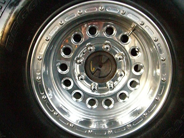

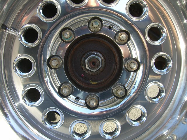

Close up, the wheel's center is larger than the hub on the H2; i.e. the wheels are held by just the 8 lugs. Is this ok?
Also, the stance is much wider than stock, even though the tire is same 12.5".

A lugcentric mounted wheel, as opposed to a hubcentric one, is potentially going to be more difficult to balance, but not necessarily so, especially if you can get them balanced on the truck.
What size are the rims, width, backspacing, etc? </div></BLOCKQUOTE>
Phil,
Have you seen the hub adapter that mounts on to a normal balancer which has fingers that goes into each hole simulating a hubcentric fitting?
Though my wheels are not a hubcentric fitting, we used that adapter. The other thing is, we got a better balance from doing a static balance on the machine that doing the inner/outer setup.
Mark

Ric, I checked on hubcentric rings, but no one has them in the correct diameters. Too large (130.1 to 116.7) for anyone to stock.
But I was told that I need a different set of lug nuts (a different taper than oem), which will work much better in centering them.
