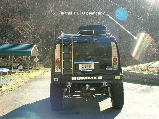

Here is another pic of my 03 H2.

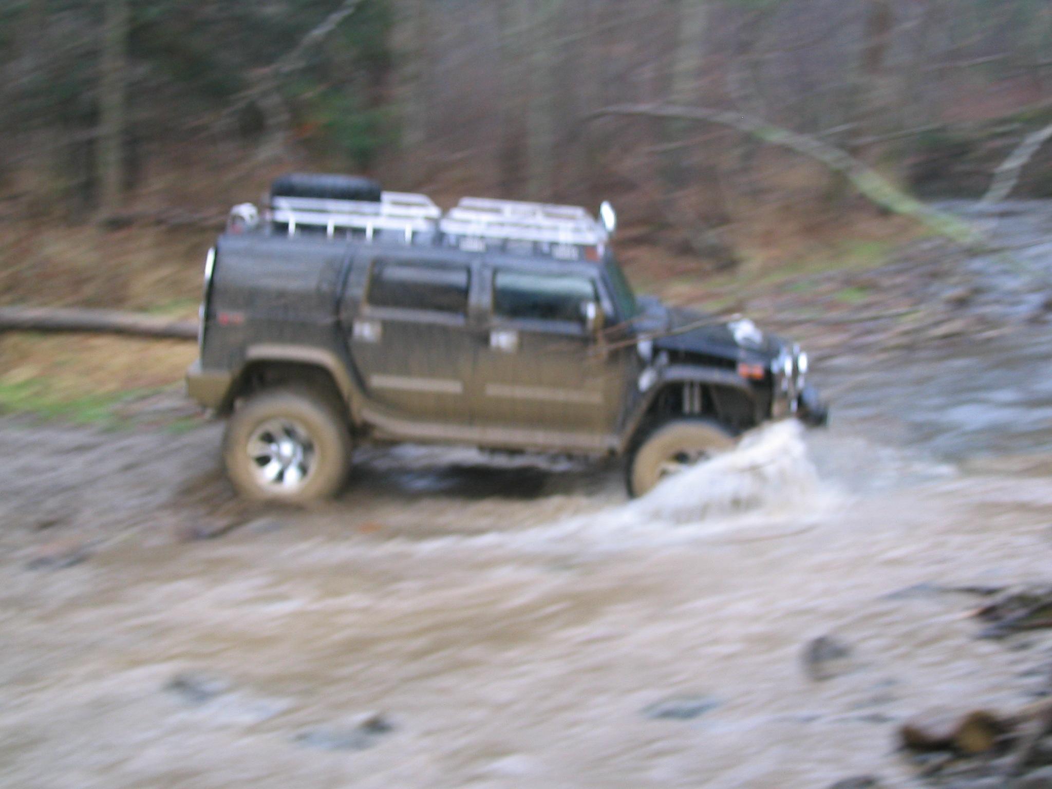

One more

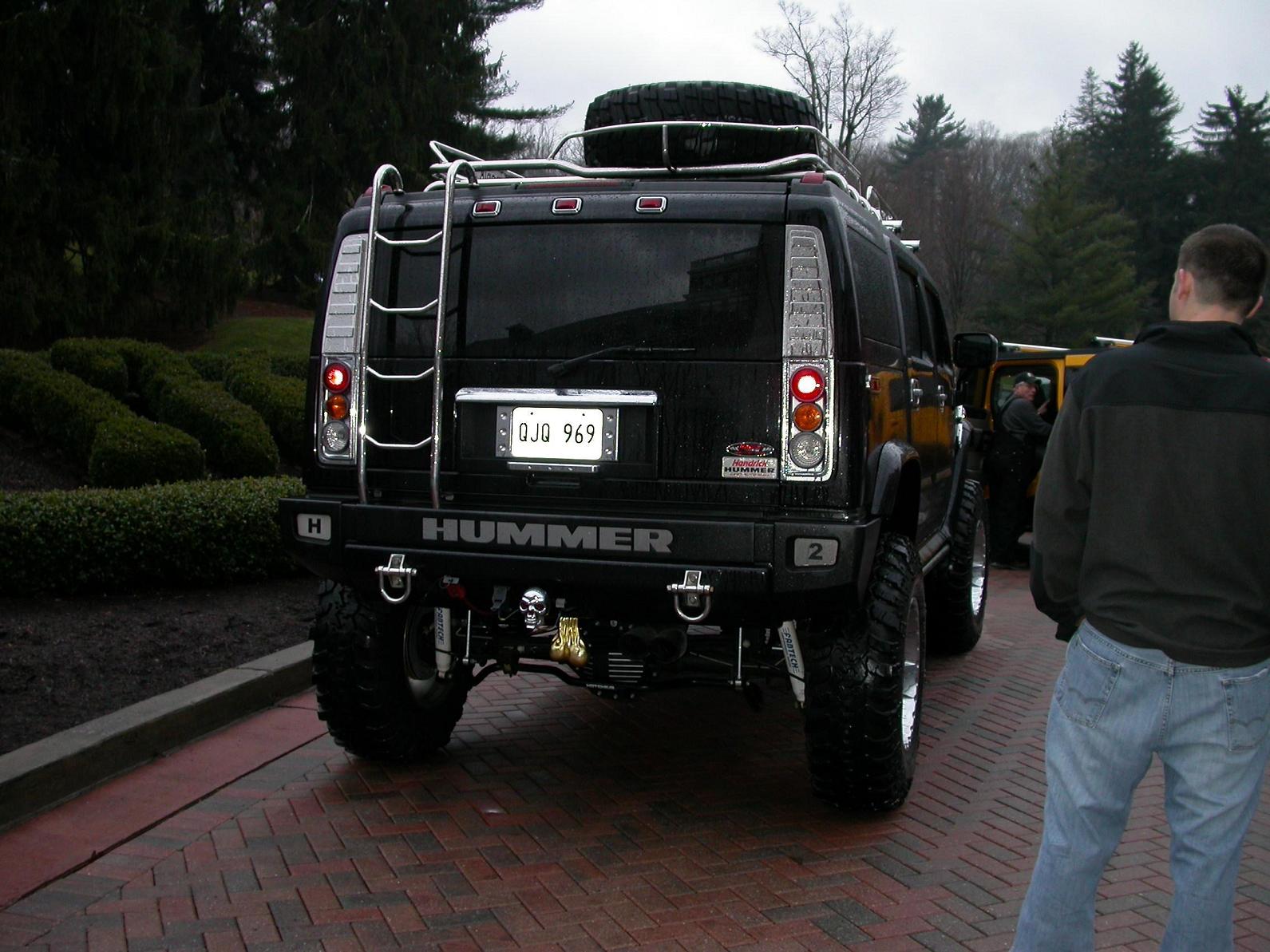

Here is one more

Very nice! Off-roading MAX-BLING!

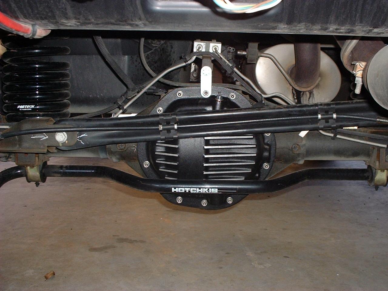

Hi SFOX The Diff cover is made by a company called PML you can find them at yourcovers.com it goes for $175.00 I put it on when I swapped the gears out to 4.88's. And how do I change the picture size to 640x480? Any help would be appreciated. And thank you all for your nice comments.

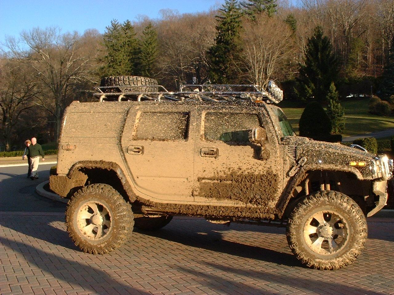

One more pic this was at the end of the trip in Hotsprings Va

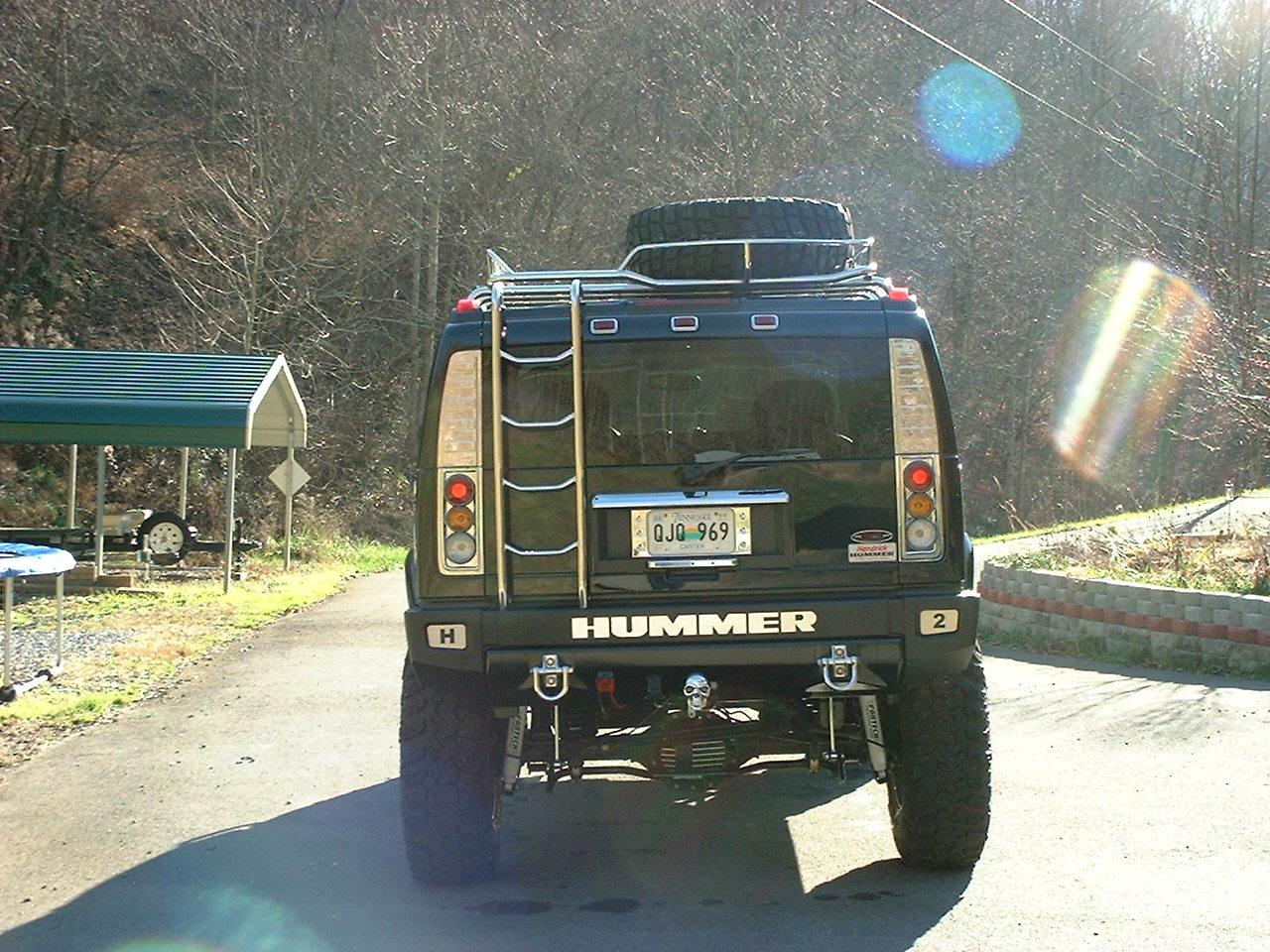

Thank you Jonahs for the help and complements I resized this one hope it works

Here is a closer look at the differential cover

what are you running for wheels and tires, also lift?

Hi Andre I am running a FABTECH 6 inch lift with Multiple front shock system and FABTECH skid plates and duel steering stabilzers. The gears were swapped out to 4.88 with a e-locker in the front. The wheels are MKW 20x11 the tires are 39x13.50x20 IROC radials. Since that photo I have changed the trailing arms and panhard rod. Also running HOTCHKIS front and rear sway bars. When the tie rods come in at fabtech I will be replacing those along with the pitman arm and idler arm. I have a set of fox racing shocks with remote resevoirs I have not had time to install yet.
