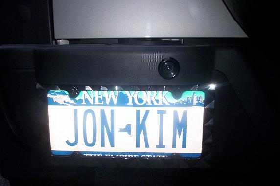

okay. i am going to look at it tonight. right now i am thinking of mounting it at the rear plate, and hang it towards the driver's side. i am going to hook it up and play around with locations before i get started.

Mines on the plate overhang.

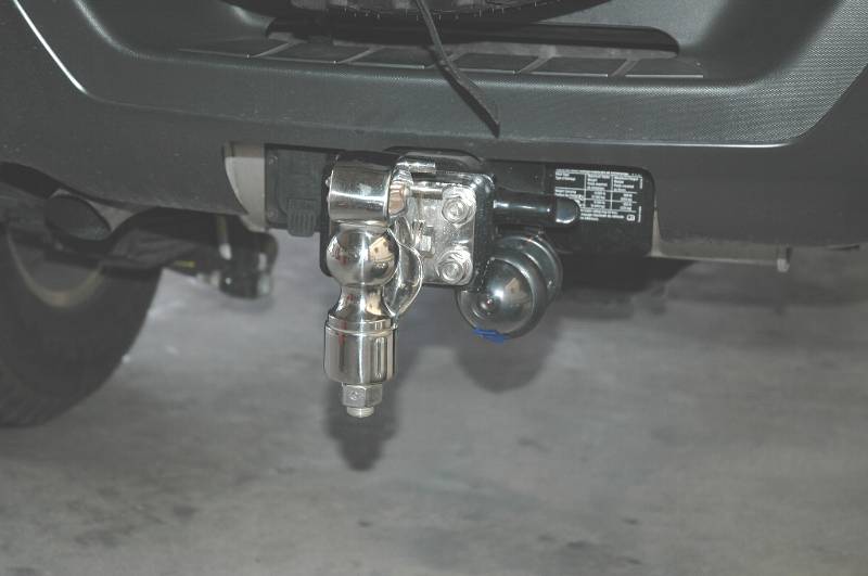

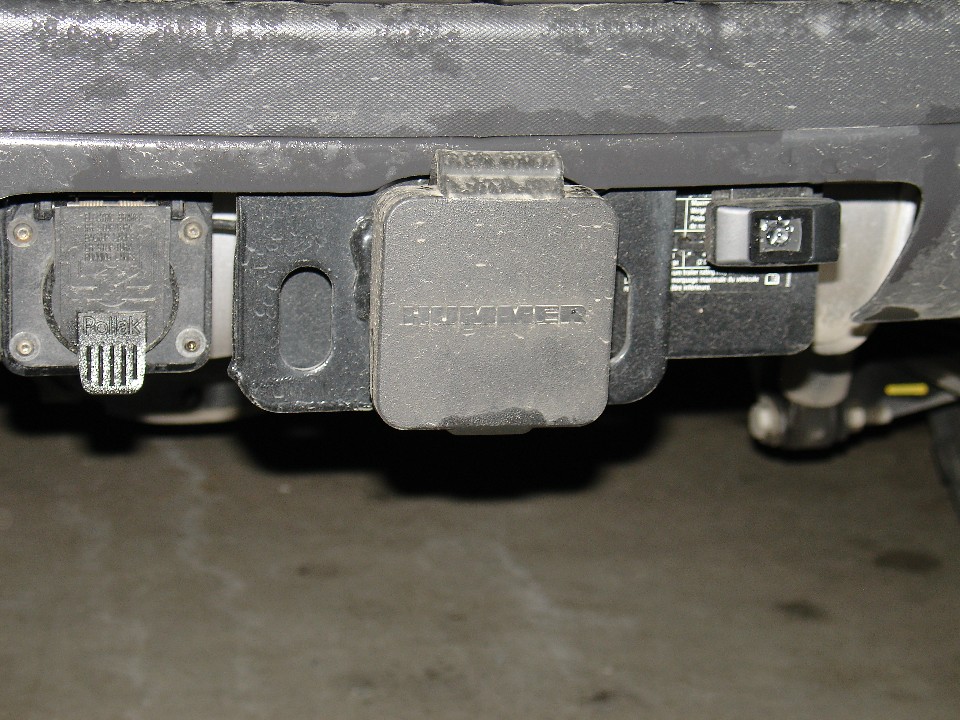

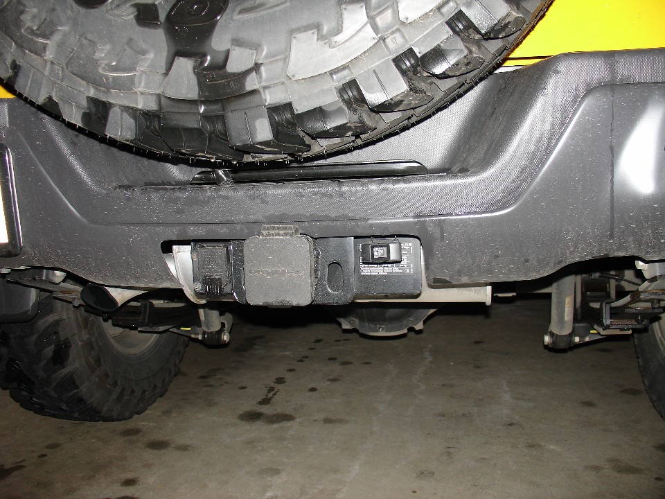

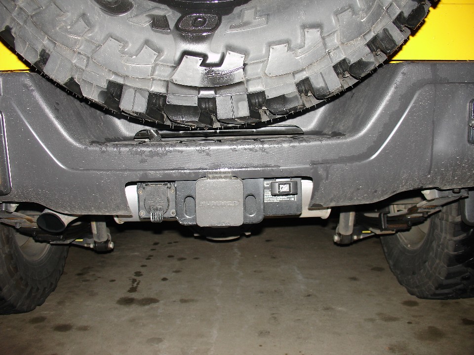

I put mine on the right side of the trailer hitch...
A few pics:
