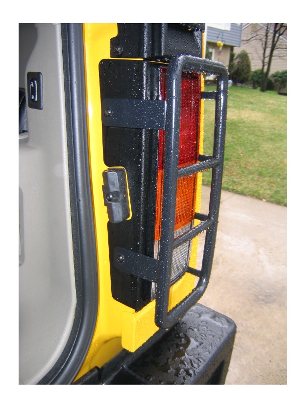

Easy, the "inside" of the guard (the side with the two brackets with the holes in them) bolts inside of the rear door jamb. The "outside" of the guard (the side with the brackets with the double sided tape on them) attaches with double sided tape in the grove to the outside of the rear lights.
Old 04-04-2004, 04:35 PM
Spike Spike is offline
Location: Whereabouts unknown
Posts: 2,267
JMV1210,

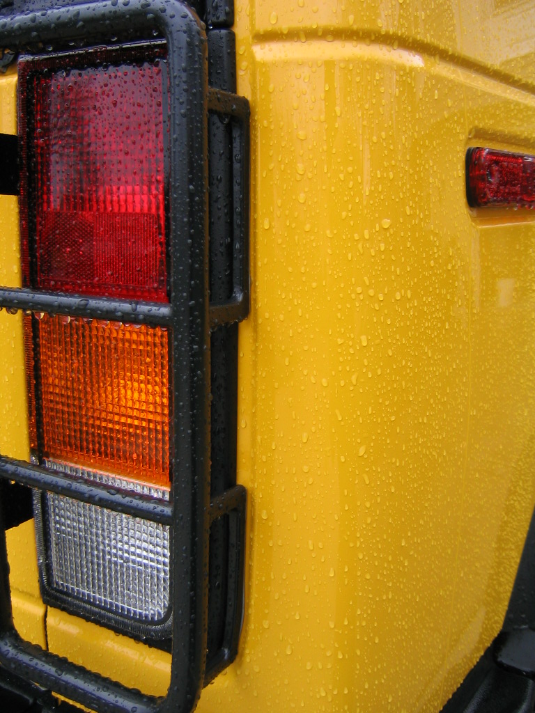

Here's a couple pictures to give youy an idea what the install will look like.

Another shot

How come your bolts aren't rusty Spike! About a week after I installed my guards they were rusting.
