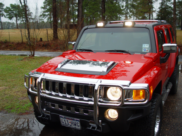

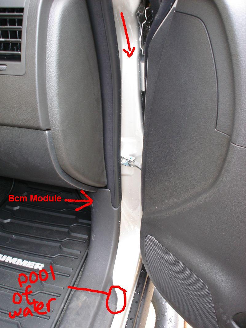

i was washing the H3 today for the first time, and i noticed the water went weird places, the dealer recently fixed my orange roof lights...tell me if yours does this, thanks.
if u dont see the pics or somin let me know.
the red arrows in pic 2 & 3 show the path of the water.
^^^ is it supposed to be there?
^^^ what about tehre?
that last picture is sweet  its all gone now. lol

what i mean was that they had just fixed the roof marker lights because of the noise and maybe put it on wrong, and i was wonering why there is water in all the door jams (between front and back door, etc)
01-21-2006, 07:50 PM
Location: Cheyenne, WY
Posts: 809
The last photo (not the Candybar one  ) doesn't look right. There shouldn't be a gap like that. My center marker light unit is completely flush with the pillar units.
I think this is the cause the water pooling in the door jam. I think you're going to have water leaks if it remains like that.

its not as big of a gap as it looks in the picture, but the other side is flush, and it did it there too, so idk..

i got the roof off road lights and they are a lil weird too.. im sure they are rusting like crazy in there

Well I can tell you from first hand experience that the water leak is headed rite towards the BCM module.I had the same problem they found a pool of water in the same spot.That leaked fried 2 Bcm Modules within a 2 week period I wouldnt wait around to get it fixed.They did finally fix leak and all is well so far.

I believe they all get water in the door jambs, mine does. You have water in your rear door jambs also, which have nothing to do with the roof marker lights. Whether or not it could cause damage, I can't answer that. Whenever I wash mine, the last thing I do is open all of the doors and wipe them out.

Its clearly out side the seal that seals the interior of the auto . Any car would get water there in a high preasure wash . IMO
