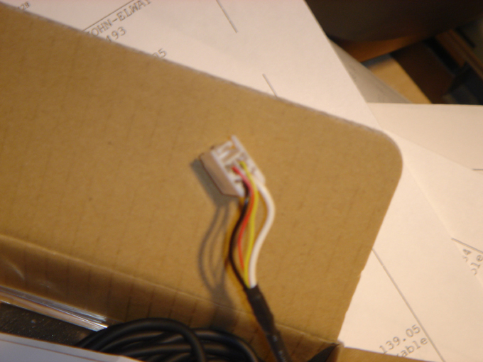

Yaki taki, yaki turi ahhh soooo, chow mein, da da da da dan da da, everybody was kung foo fighting. Ok, so much for my chinese!! Here is the pic of the plug with wiring as follows:
pin 1 (top right looking into ass of plug) is yellow video signal
pin 2 top left red is 12v reverse switched
pin 3 lower right white video shield
pin 4 lower lfet black ground
Try that confucious!

Dat seem tu wuk velly well... Butt yu say no poseeble tu buy riffout buying camera?
Just one question... is that plug attached to the camera or does it plug in separately?
I ask because if it's separate, perhaps I can buy a replacement from Fujitsu Ten. (of course, those bastards are a PIA to deal with)
Kodiakz, Thanks man for your help. I'll tear it out this weekend and hardwire if I have to.

Location: CO
Posts: 594
It is actually on an extension that plugs into the camera so it might be available separately. I will call eclipse today and see if I can get that part.
