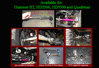

http://www.fly-n-hi.com/gm_steering.html
Heavy duty ties rod stuff. If this stuff breaks. I’m I out of luck trying to replace with stock tie rod parts. Or should I stay all stock OEM carry stock replacement parts.

Scenario: you’re on the Rubicon, your rock climbing and need to avoid an obstacle ahead of you. You don’t realize your right tire is up against a rock face. You turn right but the tire doesn’t move. You bend your tie rod or break a tie rod end.
Likely or unlikely?
Scenario: you’re at Moab and you drive down into one of those bowels. You start to climb out the other side and you lock your rear dif. Your rear wheels start to spin. You give it more gas, the back end starts to bounce. You bend a tie rod.
Likely or unlikely?
Scenario: You’re divining over boulders in a desert wash. Your H2s skid plates protect the tie rod.
Likely or unlikely?

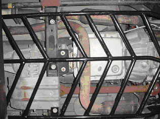

Will this help? Pictures below.
Front skid cage

There has been much debate about the H2 Tie Rods.
Personally I think they are too small. However, all of the replacements I've seen, I feel are too strong, and could cause transfered energy to break a much more expensive part that would be harder to fix.
For now I think the best bet is to carry a spare.

If anyone wants some SS sleeves to reinforce the tierods I can PM u the info for person that makes these for the HD p/u trucks.
They are bending or breaking the tierods dragracing.

The pic I tried to borrow and paste was too big so I'll have to resize later and post it.
The guy is selling them for $75 shipped.
The OD is 1" and it buts up to the lock nut and extends to the inner boot.
