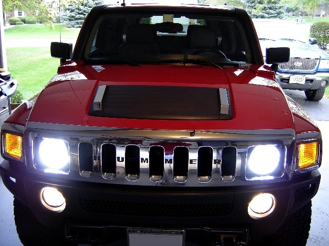

I ran a piece of masking tape across the grill measuerd both ends and then butted the letters up against it so they would be strait.

Thats exactly what I did. I ran masking tape accross the grille and measured the placement of each letter from the bottom of the grille. I used a clear epoxy that comes in two stages. You have to mix the elements together, then let it cure for about 10 mins then I used a popcycle stick to apply the glue to the back of the letters. Careful not to over do it on the application of the epoxy. Once you apply the letters I used masking tape to hold the letters in place and to keep presure against the letters for 18-24 hours. The epoxy can be purchased at a hardware store. It looks like a double hyperdermic neddle and its some very strong stuff.

Those are McCulluch 8000K H.I.D. lights. I purchased on ebay for about $300.00. They look white in this pic due to the angle of the camera shot and they do give off a blueish tint which can be seen eaiser at night.

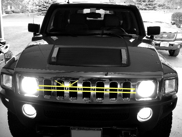

Just another tip about affixing the letters be sure to park on level ground. I'd even checked the tire presure to make sure the vehicle was not at a slight angle. Use a leveler. I didnt want the letters place at an angle becaused I park on a uneven surface. Be sure to mask off top and bottom of were the letters will go. Remember the grille has a slight roundness to it so you will have compensate for that. Be sure the spacing of the letters are exact on both sides of the single bar(see yellow arrows)And most of all take you time!!! This glue is some strong S**t you dont want to screw up your grille by missplacing the letter. Long and short of it, Your gunna have to really eyeball it. Get you wife or friend input on the letter placement before you affix the letters just as a verification. You can get transfixed on the placement and be off a lil bit, so an extra pair of eyes can help.
