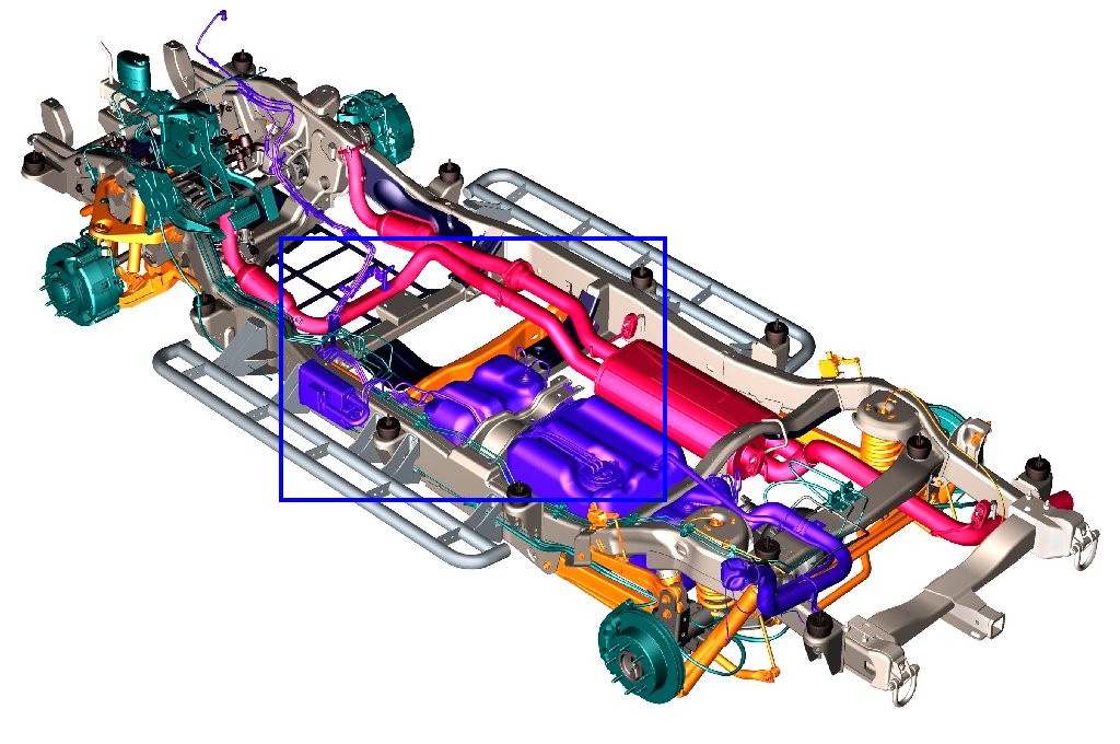

I found this cad picture of the area in question. The leak appears just forward of the orange cross member, in front of the fuel tank.
