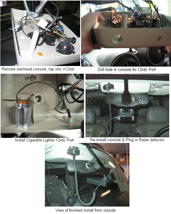

Ok... I got tired of the power cord for my radar detector hanging across my dash so that it could get power from one of my 12 vdc power ports. So, I installed a Cigarette lighter port in my overhead console so the power for the radar detector could come from near the detector instead of all the way down by the center console. I also installed a small switch so the power to the power port could be turned on and off.
Steps needed to complete this.[list]
<LI>Remove overhead console and let it lay on the dash.
<LI>Locate +12vdc (I used the sunroof switch +12vdc so it would turn on/off with the key.
<LI>Tap into the +12vdc and ground
<LI>Run in and out of new switch, install switch in console
<LI>Drill hole large enough to fit the Power port assembly.
<LI>Install power port into the overhead console. Solder positive wire to center stud of power port, and solder negative (ground) wire to the outside of the power port.
<LI>Test proper connection with a volt meter to ensure correct install.
<LI>Re-install overhead console - Your done.

Old 01-23-2006, 12:10 AM
Looks nice and clean Dewi...Now get to the XM

BTW.. Yes, I did wash off the dirt before the pictures... those are rock chips in the windshield .... It is a Colorado vehicle!!

Nice work. Good clean install.
You do something special to make the suction cups stay on? </div></BLOCKQUOTE>
Thanks for the compliment
Nothing special with the suction cups.. The detector is a Valentine One. but it does not sit completely level and there is no way to make it lay down more due to the steep windshield angle.. Any Ideas on making it lay level?? I have other detectors that you can bend the bracket with the suction cups, but this one is fixed.

Nice job, Dewi. I'd have to drape that cord over the rearview mirror, though, as it hanging there in the line of sight would bug me as much as it did you when it was on the dash.

you should have used your V1 wire harness it comes with...
you could have tapped into the fuse box and ran that one phone cord up the pilar like i did.. very simple.

Yeah the V1 Harness is nice, except I did not want to use the hard wire harness from Valentine as I wanted it to be a universal port that any radar could plug into. I dont mind the cord in view, I just did not want it hanging across my dash and taking up a power port on the center stack.
