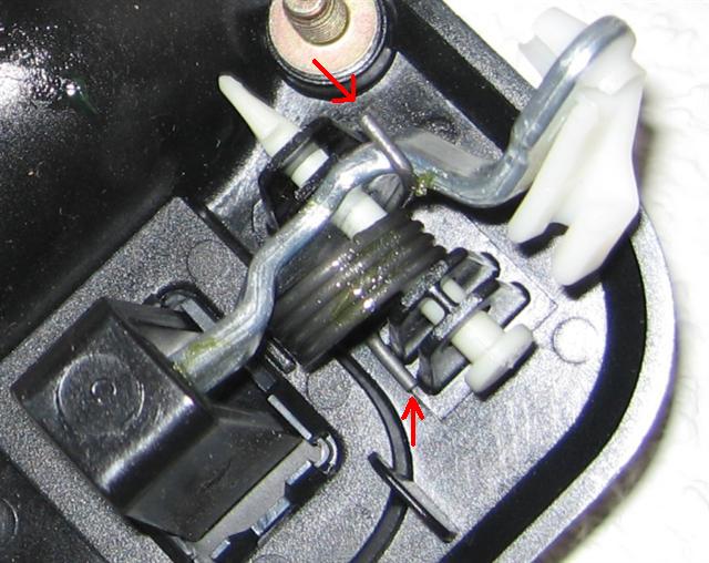

My handles arrived today (thanks, partsguy) so was able to get a good look at the back-side workings.
Maybe I'm missing something but I don't see much opportunity for adjusting the spring tension; however, if the spring wasn't installed properly, that would definitely cause the handles to rattle. Note the spring ends . . .

Thank you Taz and Rodster! Perfect photo! Clearly there doesn't appear to be a way to adjust the spring. A friend spoke with a HummerTech buddy of his who said he could do it. I don’t know if that means deforming them by "unwinding" them beyond their elastic limit or replacing the entire spring. But if this guy is willing to ameliorate the rattle, he can use Voodoo, for all I care. I may need to drive to San Diego to have it done, but it's little things like this that keep me up at night (the meaning of life is easy). I'll follow up with y'all.
