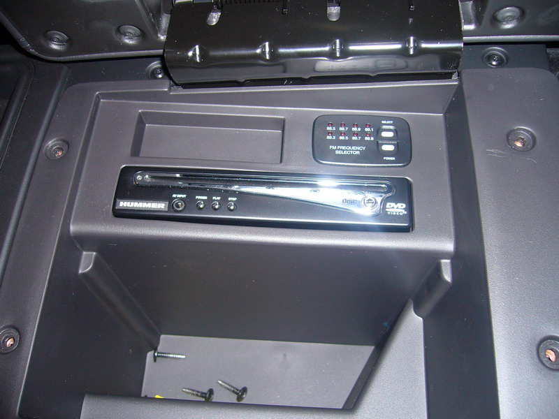

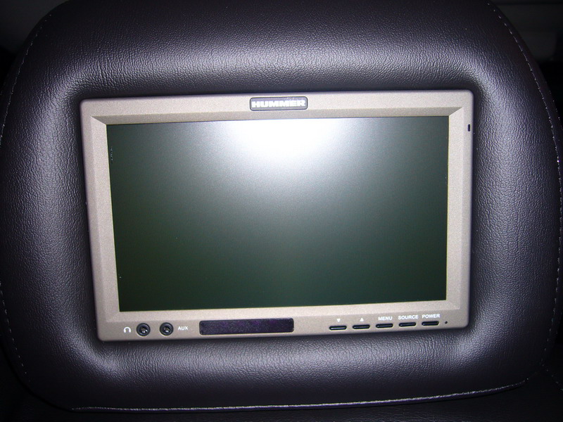

I am not sure what I have. The brand name is HUMMER.
I have attached pictures.
Looking at the pictures - I noticed there is AUX mini jack on the dvd player and screens. Is there where audio and video would come in? That seems a little weird.

12-06-2005, 01:40 AM
Posts: 59
Here is a picture of the dvd player
2006 H2 SUV, Slate Blue.

They then told me the horrible news that the system is entirely enclosed and there is no way to tap into it to add another video input. They said that there is an AUX port on the dvd player that will allow me to pass through video - but that port it on top of the dvd player and there is no way to plug a cable into it and close the lid.

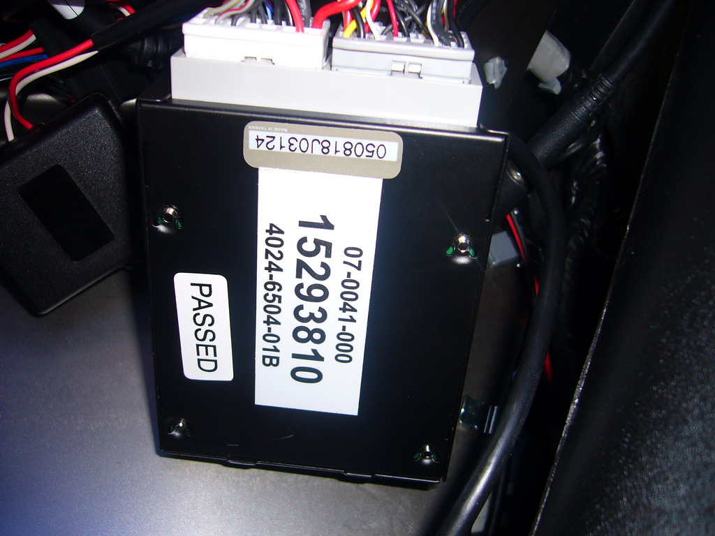

12-06-2005, 09:39 PM
Posts: 59
OK - I found the control box. Can anyone tell me what I can do with this? i don't see any inputs or places to plug stuff in

Jesse, Viz definitely mads your unit! My rep even called me a few weeks back to warn me that I might start seeing some of their systems as oem installed units, but that it was just a promotion (yeah right!!). Anyway, what happens when you press the source button? Kind of silly to have that button if it does nothing. I could try to contact viz for you and see if I can get a pinout of that module for an input, or you could take the dvd apart and solder on a set of rca jacks to the inside of the aux in jacks. Is that box in the center console? </div></BLOCKQUOTE>
Here is what I have found out. This control box is in the center console between the storage compartment and the shifter. On the screens there are 3 video inputs. Aux1=DVD player
Aux2=Auxiliary port on the headrest screens
Aux= The mini din port on the front of the DVD player.
Coming out from the DVD there is a cable that has 12 wires.
A Red and Yellow (power)
Two black wires (I assume ground wires)
Three multi color blue wires Blue/yellow, Blue/white, and blue/red (I believe this makes up video and left and right audio channels for either AUX1 or AUX3.
Three multi color green wires Green/yellow, green/white, and green/red (I believe this makes up the video and left/right audio channels for either AUX1 or AUX3.
Two brown wires I assume these must be the ground wires for the AUX1 and AUX3 not sure which is which.
This leads me to conclude that if I can figure out which of the 2 sets of 3 are for the AUX3 input I should be able to splice into that set and create one set on RCA inputs for an xbox or whatever.
I am also going to add the USA Spec smart DVD interface the one found here I was told that will add one audio input to the head unit and it will be displayed as RSE (rear seat entertainment) this will be one of the cycle of inputs on the head unit. Now to somehow get the audio out of the rear seat entertainment system I think I will have to examine the wires going to the FM modulator this part I will need help.
I am also adding the PAC Audio VCI-GM2 adapter to hookup a rear camera and bring video to the nav screen. I dont know how I will be able to have all the different video displayed so I am just going to tap into the video coming out from AUX1 on the dvd player. This will at least bring dvd video to the front.
