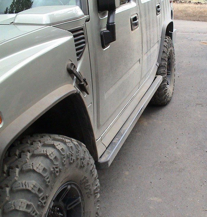

Has anyone ever tinkered with their rock rails?
I was checking them out today and though sturdy, the cross sections appear they might catch.
I was thinking that perhaps you could fabricate some extra protection on the bottom and extend them out a little, and the protrusion could negate the need for a step.
Any thoughts..

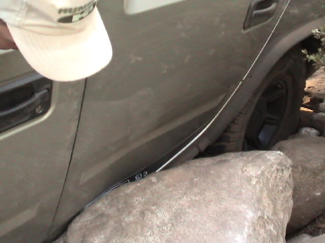

Yes, they do "catch". But the frame is what you need to worry about.
Old 11-28-2005, 04:02 PM
The stock rails are great for sliding over things, but side protection is seriously lacking.

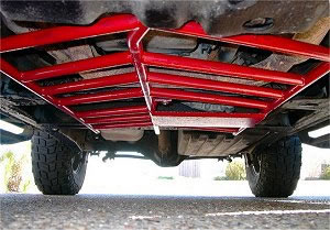

That damn rock is why I built these bad boys.
Old 11-28-2005, 04:16 PM
Drty, I like those. Do you have any more pics?

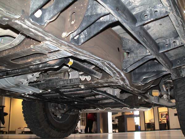

While I am under there, is there any harm in adding piping and/or steel plating to the rest of the undercarriage. If not, what things should I leave exposed for repair and maint. (manifold etc..) or should I make a removable "cage" supported by structural piping.

I just went out for a lil' look-see and my underbody is different with the fabtech arm things and my pumpkin looks so vunerable. I want something.
Ken, already talked to Phil about his "UBP" and apparently- there is such a thing. I know, I am a dork.
I will be altering my rails though.

Well, I don't see an aftermarket kit for H2 under body protection. So I guess I will have to make something unless someone knows any different.
I am worried about the rear diff too H. I think the wheel thing is a great idea, however, it is another movable component to worry about.
I'm thinking something like the undershield (just posterior to the skid plate) but with a steel panel veneer to slide on. Because if you just add another undershield you get that same 'catch' problem. The pumpkin can just have a two bar frame and a steel panel with hinges for access if needed.

CP, you're aware of the replacement heavy-duty UCP from Rubberduck? It's 2 pieces, front and rear. Also, I belive Neil (H20) made an even better version. None protects the rear diff, though as often as I've slammed it on rocks, it seemed plenty tough.
