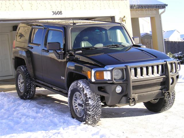

Old 12-07-2005, 03:11 AM
Old 12-07-2005, 09:14 PM
<BLOCKQUOTE class="ip-ubbcode-quote"><div class="ip-ubbcode-quote-title">quote:</div><div class="ip-ubbcode-quote-content">Originally posted by HummBebe:
</div></BLOCKQUOTE>
Ok, but just one.
