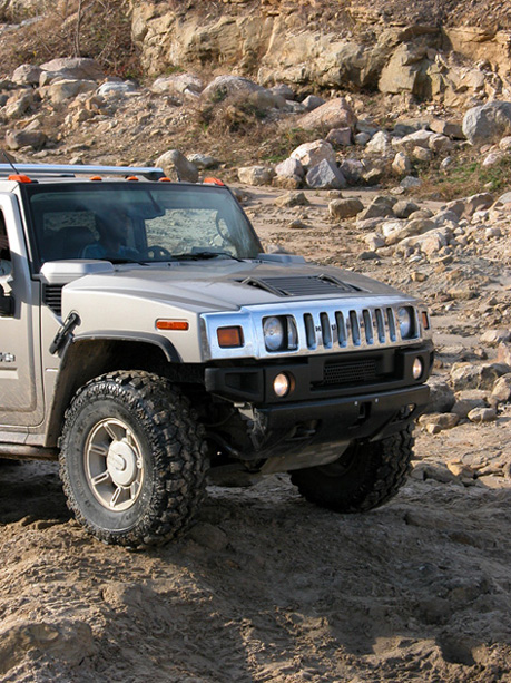

Here is the Adventure Team H2 with the new 4" lift, 37's and GOBI rack. We slapped a little chrome here and there.
This truck will never see the inside of a garage!

Do you have any pictures posted of your H2 with the 37s?
Any change in MPG after your added your 37s? Not that it matters much since I get in the mid 10s right now anyway. I added headers, exhaust and intake mods with no change (for the better)in MPG.

Does a lift gain you ground clearance (not like you don't have enough)?
What does the kit include? How does it work with IFS/IRS?
Are you running larger tires with the lift?
Where do you store the ladder to climb into that thing?

Kirk,
I am very pleased with it. The alignment is fine, tracking fine.
It is a different vehicle with a 4" lift. You thought people noticed you before, wait till you can look down on the rooftops of suburbans!
With my rack, it adds another 18" or so of overall height!
I'll post a few more photos as well...

Any difference in ride quality? Does it track straight? I am very close to putting the Rancho lift on my H2, but I would like some feedback from someone with this lift kit.
Any information would be appreciated.

Albie,
Yep, I really liked the MC2 vents. Looks cool with just the forward facing holes.
http://www.t2hummer.com/T2Hummer/vents.HTM

hey Travis pretty bad A$$. Hey are those MC2 Side Vents?

David,
I was just playing in photoshop.... Instead of blurring out the plate, I just kinda reversed it and changed some numbers. Too much time on my hand that day, I guess. Good eye!
It is a Rancho 4"

Its a Rancho 4-5 inch kit.

looks great. How about a side photo and a back photo.

I hope you did not get a lift to fit 37" tires...
37's fit fine on a stock truck.
Gains of a lift Kit
--Break over angle increased
--approach and departcher angles increased
--running clearance increased
--Breathing cleaner air up there
Draw backs
--high center of gravity
--limited visibility
--does not fit in some trails
--reduced side slope traverse
--Risky on advance trails
How to compensate
--need to widen wheel base (( not likely ))
Truck looks huge and grand.

No a suspesion lift does not give you more ground clearance. What it does is give you more room to add a taller/bigger tire and thats where you get the ground clearance from.
The basic geometry remains the same whether it be a 2,4 or6" kit.
Tires no longer rub and flex and droop are increased in many cases.

How come your front plates are reversed? The GOBI and HUMMER logo is normal?
