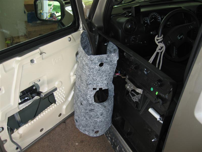

Old 02-01-2006, 12:53 AM
mstams
Great info!! Thanks for posting.
I've been thinking of taking mine apart to tackle the creaks and rattles, but I wasn't sure what I'd get into. This definitely helps.
A couple of questions:
What is the best way to grip the panels (both in #3 and #4) to make sure nothing snaps off when I start to pull?
Also, I've always thought that running some kind of trim or bead of sealer, caulk, or something would help tremendously on the plastic to metal source of the creaks. Do you have any opinion on whether this would help?

Steps to removing the door panels.
1. One phillips head screw holds on the plastic trim panel behing the door handle. Remove the screw and then the panel.
\'05 SUT

<BLOCKQUOTE class="ip-ubbcode-quote"><div class="ip-ubbcode-quote-title">quote:</div><div class="ip-ubbcode-quote-content">Also, I've always thought that running some kind of trim or bead of sealer, caulk, or something would help tremendously on the plastic to metal source of the creaks. Do you have any opinion on whether this would help? </div></BLOCKQUOTE>
First, I'm not sure the problem is plastic on metal. Might be, might not be.
Take a look at the fasteners in pic 3 -- see the black "collars" around each fastener? That's part of what insulates the panel from the door. The insulators are about 1/4" deep and slide off the fasteners way too easy. If your door panels have ever been off (they may very well have been removed at the dealer before you bought the truck) and you're having lots of squeaks, I'd first check to ensure you have all the black insulators.
Check the two screws in pic two above. Are they tight?
Are the speaker screws tight?
One thing we don't know (although it might be suspected) is, is the noise coming from the door panel? It could be coming from inside the door. Perhaps go for a drive after you take off the first panel. Noise still there?
After verifying the source of the squeak (door v panel) and after verifying the insulators are in place and all fasteners and screws are well-seated then maybe, yes, one of the remedies you mentioned might be worth trying.
That said, personally, I'd be reluctant to start caulking, taping or otherwise sticking together parts that you may want to disassemble some day.
If your door didn't squeak when new, it stands to reason something is now loose and it seems feasible that what's now loose can be made snug again without adding caulk, etc.

Old 02-01-2006, 12:37 AM
rodster rodster is offline
Posts: 1,571
rodster is off the scale
3. The door panel is now held in place by plastic fasteners. Work your fingers under any edge and pull straight away from the door. Brace against your pull -- once one lets go, they all tend to want to let go. If you let that happen, it'll put sideways stress on the remaining fasteners and break them.
You can see the fasteners in this picture. Some are black, some are white. (The gray insulation is pulled back and foam cut in this picture because I was replacing exterior door handles.)
\'05 SUT
