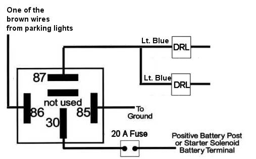

Below are two schematics to wire your DRLs:
The first one uses your parking lights to activate the DRLs.
The second one uses a switch that you install inside the vehicle.
First, some relay basics:
There are two basic circuits in a relay. One circuit turns the relay on and off; the other circuit passes current through the relay once it's turned on. The wire going to terminal 86 is the wire that activates the relay. When terminal 86 has power applied to it, the power goes through the relay to terminal 85 to ground. This turns the relay on. This allows high current (power)to go from terminal 30 to terminal 87, which puts power to the DRLs.
Basically, all you have to do is splice into one of the existing parking light's positive lead to the 86 post on the relay. Next splice both positive leads from the DRLs and combine into one wire of similar thickness. Take this combined wire and plug it into the 87 post on the relay. The rest should be self explainatory.
Standard disclaimer applies. Email me for disclaimer info. [img]/infopop/emoticons/icon_smile.gif[/img]

It seams to me that if you use the parking lights wire to trigger the DRLs after dark by splicing the pos lead to the 86 terminal on the DRL relay, during the day when the DRLs would normally be on, the current to the 86 terminal normally present will travel backwards up your splice into the parking lights circuit and activate them also. Anybody see a reason that this wouldn't happen?

The parking lights have their own relays too (labeled 'PARK LP' located two relays above the DRL relay). So even though there's power to the parking light fuse, the relay is off so the parking lights will be off.
Again, I will take photos of all the stages once I get the H2 back.

Which color wire of DRL to splice into?
Just to be sure I won't short circuit the rig and cause major H2 bom! Thanx again. JCJ

It's the light blue wire.

Use the brown wire if you're splicing into the parking lights(This would be the source wire to terminal #86).
#85-Ground
#30-Fused connection from (+) at battery
#87-To DRL's or whatever you're putting power to.
I know you can do it. [img]/infopop/emoticons/icon_smile.gif[/img]

Could you make it even easier for me, the relay rookie, by pointing out the color of each wire on your diagrams?
I tried puzzling it out under my H2's hood, but got confused by blue, black, brown etc. colored wires attached to head lights, parking lights, turning lights and DRLs.
How come, when you say to splice into the turning lights, the DRLs don't flash when the turning signal is given?
Thanks, buddy, JCJ

I haven't done the relay kit approach as I'm still trying to get the fuse solution working.
Your relay kit connection is partially correct. I'm not sure if the + wires are black (normally this is reserved for ground). If you have a voltmeter, you can find out rather quickly.
#85 should be to ground. #30 should be to + power. Just review the pics at the begining of the post.
As far as the fuses, I tried it and the parking fuse to the DRL relay did not work. Either the schematics are wrong for the relay points or there's a constant 12 V through the parking light fuse. One other thing I'm going to try is to trigger it on the parking light relay itself. I got lazy and did not put a voltmeter to it to see where the switched power would be to power the DRL relays.
When I get back after New Years, I'll spend some time to trouble shoot the connections. I'm going to get this working yet. BTW, the relays are a b*tch to take off. You have to pry it off with a chip extractor or a thin blade screwdriver. Man they are in there good.
