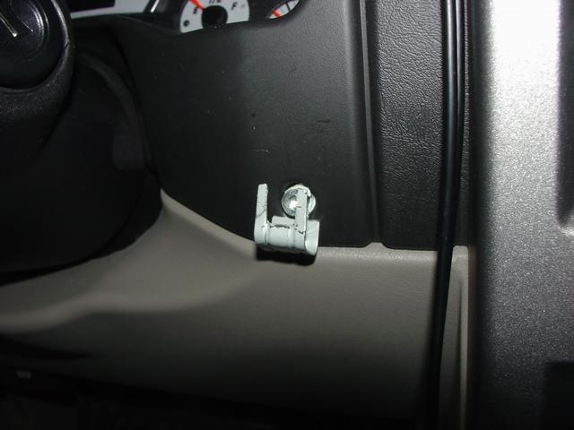

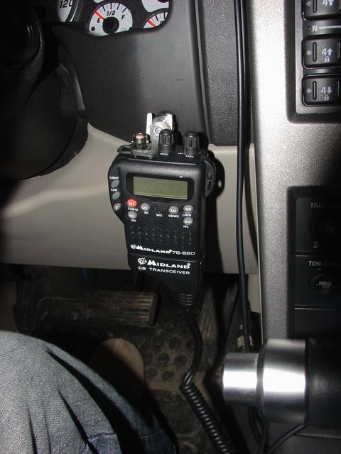

Old 02-23-2006, 03:57 PM
ree's Avatar
ree ree is offline
Posts: 1,260
This is the handset hanging on that hook.
It's an aluminum hook so it could be bent if you really pushed/pulled on it, but it's pretty small and out of the way. And I filed the edges a bit so that it's not rough on you if you drag your hand across.
Best thing is I can simply remove it if I come up with a better solution.

Old 02-23-2006, 09:17 PM
Racer-X's Avatar
Racer-X Racer-X is offline
Location: Staind.com
Posts: 1,239
Racer-X is off the scale
Looks nice. I put my CB in the same place but I don't like it. It's in the way of putting key into the ignition and I can't see the display when driving. I plan to move it soon. I'm going to fab a bracket off where you have your ipod.
Old 02-23-2006, 03:51 PM
ree's Avatar
ree ree is offline
Posts: 1,260
The I cut it where the fold was, drilled a hole right near the bottom and attached a small pull I found in a junk box with a small bolt and nut.

Old 02-24-2006, 12:34 AM
ree's Avatar
ree ree is offline
Posts: 1,260
<BLOCKQUOTE class="ip-ubbcode-quote"><div class="ip-ubbcode-quote-title">quote:</div><div class="ip-ubbcode-quote-content">Originally posted by Racer-X:
I put my CB in the same place but I don't like it. It's in the way of putting key into the ignition and I can't see the display when driving. </div></BLOCKQUOTE>
Mine hangs low enough not to be in the way of the hands when putting the key in, but visibility is poor. My hook is loose enough to allow me to reach down and swing it upward a little and see the LCD through the wheel spokes though, so it hasn't been too bad.
'03 pewter base H2
