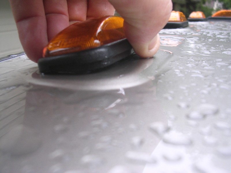

Here ya go.....check yours, you never know.

BAD......Some dealers or service techs assume that when the roof leaks and it has a sunroof that it must be the roof (or drain hoses) thats leaking. Most leaks happen only when it rains hard. So they assume one of the drain hoses must not be draining fast enough, so they check them, if they find a small crimp or bend in the line they think they found the problem, and move on. The same problem occurs in vehicles with no roof like mine. When it rains hard the cab lights lift up off their seal and water leaks in.
Open your door, stand inside your truck, where you can reach the cab lights, grab one in the middle and lift gently and you will see what I'm talking about. It's been a problem with GM for quite some time. The dealer has a solution for this problem, just make sure he is aware, show him what your talking about.
Just some info........thought you might wanna know. Here is a pic........
