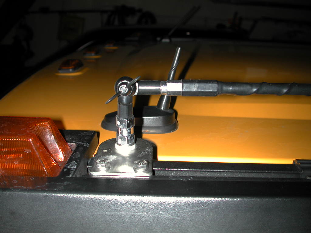

For those who have installed a CB w/ antenna, where did you mount them? I was thinking about going with the all-in-one mic made by Cobra. Nothing showing or taking up room except the cord and mic. For the antenna, I am thinking 4' black fiberglass whip mounted on the right rear bumper. Any suggestions? Thanks.

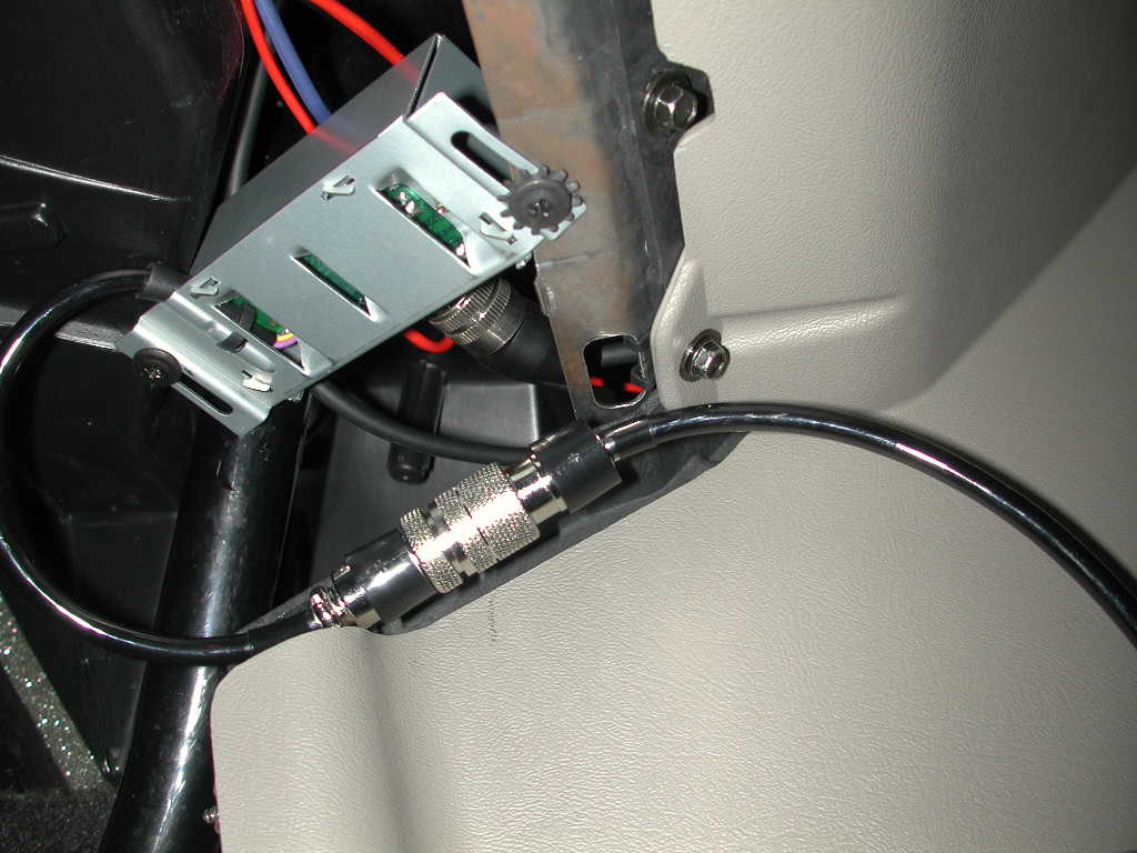

I INSTALLED MY COBRA 75 PER "GLENN" ON POST DATED JANUARY 29,2003. WENT VERY SMOOTH. WILL TRY TO POST PICTURES.[IMG]CB INSTALL[/IMG]

TRYING TO SHOW WHERE COBRA 75 WAS INSTALLED UNDER DASH.

YOU REMOVE THE FRONT LEFT RUNNING LIGHT, IT HAS A RUBBER GASKET THAT YOU CAN RUN YOUR COAX THROUGH. FISH IT THROUGH THE FRONT PILLAR INSIDE AND IT WILL END UP UNDER YOUR DASH. FOR ENTIRE INSTALL INSTRUCTIONS SEE GLENN'S POST ON JAN 29,2003

[img]CBINST~2.JPG[/img] HOPE THIS SHOWS WHERE I INSTALLED COBRA 75 UNDERDASH.

Thanks for all of the feedback. I really like the roof rack mount idea. PhilD's and others have very clean installations. I had wanted the bumper mount similar to YellowH2, but, I would not be able to clear the garage. I only have a quarter inch clearance as it is now. I will refer to the past post as guidance.

I also have the Cobra. I really like it. I have dual 4ft fiberglass antennas mounted on my rear bumper just like you were asking about. They really flopped around allot so I had to brace them to my tail light guards. (pictures below)
Inside the bumper is a thick metal plate that will need a very big hole drilled through it to run the antenna cable. It is allot of work but I think the outcome is well worth it.
