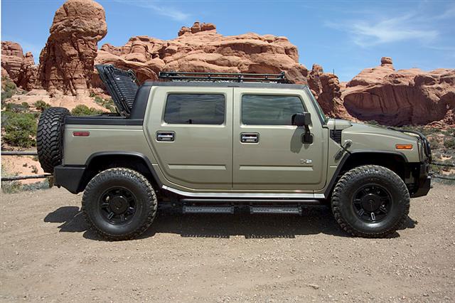

Old 01-25-2006, 01:14 PM
When open on th efactory cover, it does not touch anything. however, you don't want this open while loaded down. It won't stay open either. This way no one gets their hands shopped off.

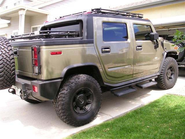

Old 01-25-2006, 12:58 AM
No aftermarket to date.
I will tell you that when I had my SUT, I had that cover and it was great. I also had the GOBI bed rack on top and could haul all kinds of stuff under the cover and it was stay dry. Coolers, H2O cans, Gas cans, bikes, coul dbe mounted on top.

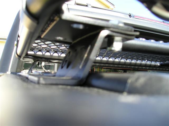

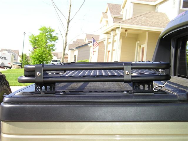

Old 01-25-2006, 01:07 PM
Rod is dead on! It mounts to the cover. When GOBI built these, we mounted it on my bed cover and out three people up there, jumped up and down, took the rack back off and not a dent. So it's built and secured just as tough as their roof racks.
You do have to drill four holes and get spacers to go in there to guide th bolts. It comes with new gas shocks so you can still lift the cover and it will stay in the UP position.
Th eother option is to order it to it mounts to the bed rails. It uses a modified bracket an T Nuts to hold it into the factory track.
This rack does not interfere with the operation of the factory cover or midgate.

Old 01-25-2006, 01:09 PM
mount. Th other rail you see is not included. That was from when I had some Yakima bike rack stuff mounted on there.

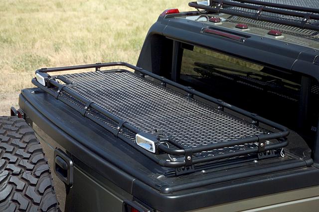

Old 01-25-2006, 01:00 AM
one more

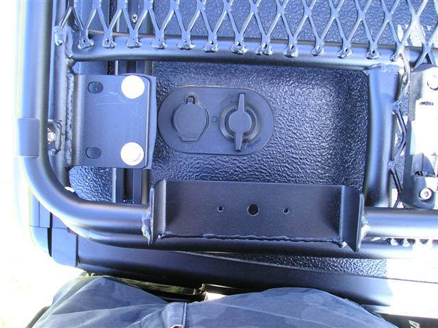

lock opening for factory cover

Old 01-25-2006, 01:12 PM
TXSUT's Avatar
TXSUT TXSUT is offline
Location: Houston, TX
Posts: 1,290
And the current production model racks do not have those allen-bolted brackets securing the top rail to the bottom as shown in Tim's pics. Welded vertical tubing is used, as you can see here...
