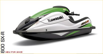

Jetskis are great! I was just telling a friend that I wouldn't mind getting another one. we started riding them in about 1989. My first was a Kawi JS300, then a 650SX. I'm in to the standups. The 650 was killer GroupK modded and would smoke my buddy's 750. Even raced locally one summer.
Haven't rode in a few years though.
I'd love to have this one!
