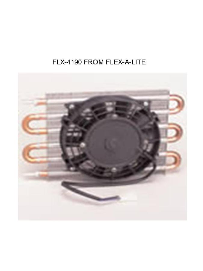

Heres one for you and there are others..

H2Ranger, ya I was looking at those on-line last night. I'm just a little leary of anything made by flex-a-lite because of the troubles I've had in the past with there fans. In all fareness the fans were probably just fine it was just a crapy job of installing the control module that I believe caused my past problems with the fans.
Thanks though I will continue to look that option and others.
you can attach any fan to the cooler (pusher or Puller)depending on mounting and location conditions.

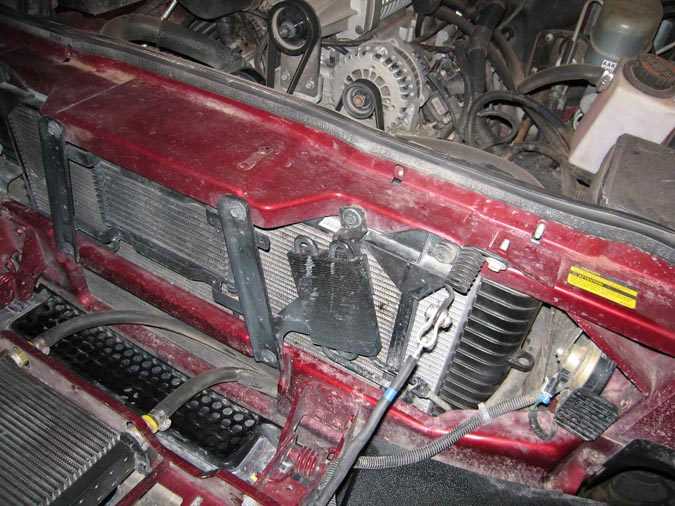

I would fashion a heat shield over the exhaust crossover first, before I did anything else. The radiant heat could simply be cooking the bottom of the tranny pan when working hard as your exhaust temps would be running higher than a stock rig would and that would show up on an extended grade climb. Cheap and easy that might just help.
Paragon, thanks. I can see in this pic exactly what you mean. The exhaust is pretty close to the pan.

Find a place to mount a 4 pass trans cooler in front. Look hard, I know there's space. That'll solve your problem.
Keep us updated, buddy.
Old 05-19-2006, 06:30 AM
Fubar's Avatar
Fubar Fubar is offline
Posts: 8,750
Default Re: Transmission Running Hot
Ken thanks.
mount a trans cooler up front, where?
there are 3 coolers stacked (4) if you count the inncooler for the s/c in front of the radiator.
The 3rd in line or 2nd largest I'm guessing is the current trans cooler, don't know what the other two are.
Perhaps if the front most one bracketed by the black braces can be relocated a new or additional trans cooler could go in it's place. ?
