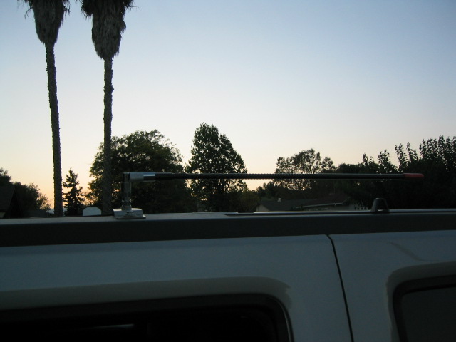

I added a fold-over mount so I can drop the antenna when I go through a low-hanging area. The reason I mounted the antenna where I did is so I can reach it out the drivers window. Thanks to the H2 guys for that idea.

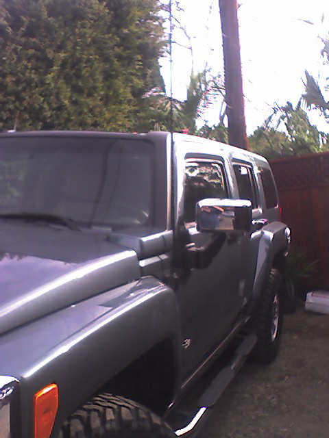

The antenna. I need to bend the mount a little. It is flush-mounted to the roof trim so the antenna leans out a little.

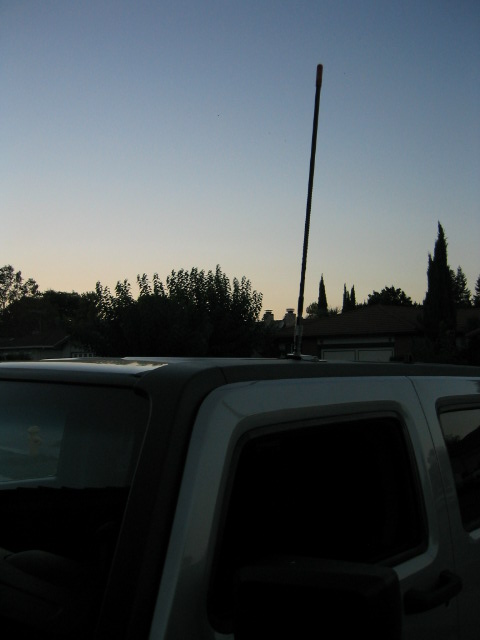

I used the Firestik Ram pickup mount kit and mounted it to the roof trim using the existing screw hole above the driver's window.

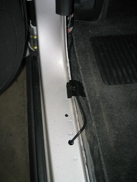

I ran the coax under the drivers side and up into the door sill. There are some existing grommets underneath.
