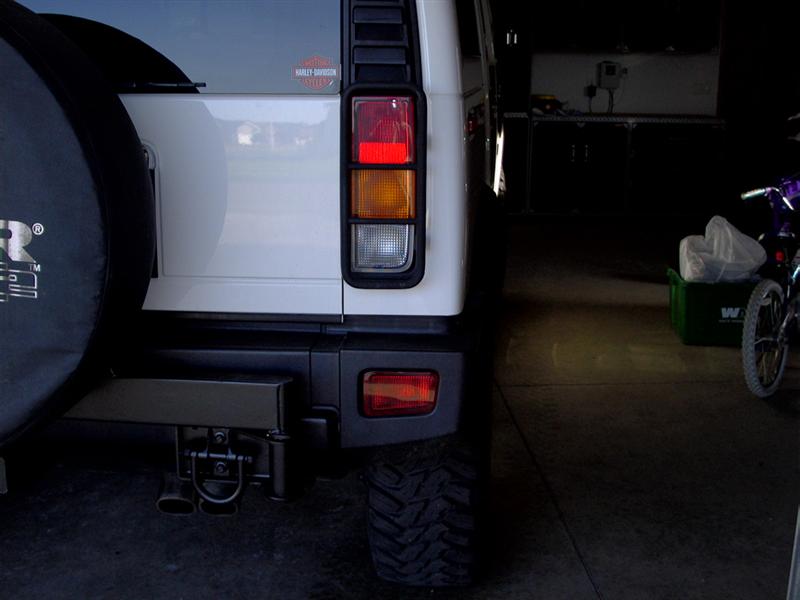

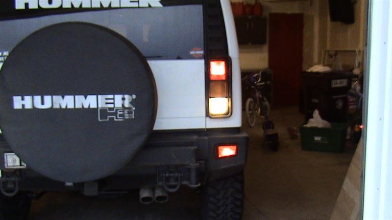

Yes, I put them in my 03. You can buy the light kit, brackets and wiring harnes, if I remember right for around $250. I got a good deal on mine so don't know retail for sure. They will try to sell you the new bumper end caps that already have the holes cut out but I just dremmeled the holes out. Just make a template of the back of the light and cut. Saves you about $150. On a scale of 1-10 this job is about a 2 in dificulty.
Old 07-09-2007, 12:53 AM
working Hummer's Avatar
Location: someplace crappy
Posts: 476
Default Re: REAR BUMPER BRAKE LIGHTS
Another

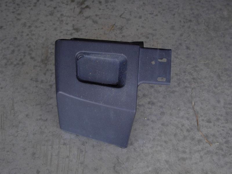

Here's the end cap they will try to sell you, but with the hole cut. Just cut your own hole.

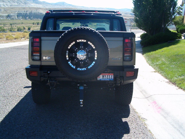

Dear working Hummer,
I am guessing I need 25, 26, 27, 28, 29, 30 and probably 23 (if 23 is different than the harness for the 2003) from the GM diagram. Does that seem right to you? Thank you. Great post, BTW.

I'm so excited. I just went to my dealer and ordered the parts for this mod. They said that they should be in on Wednesday, so next weekend...
It's the little things...
