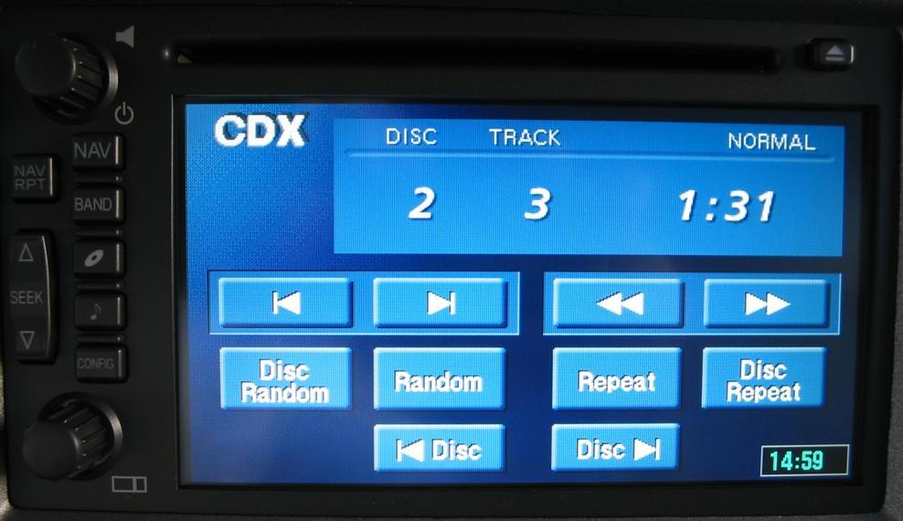

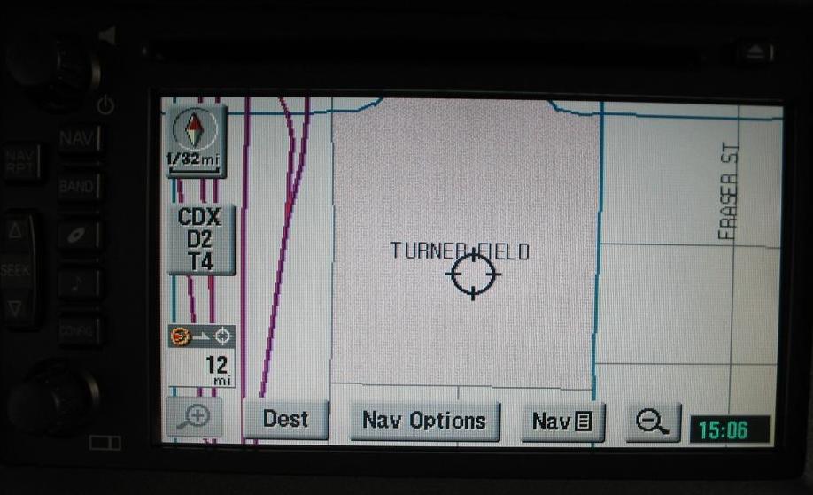

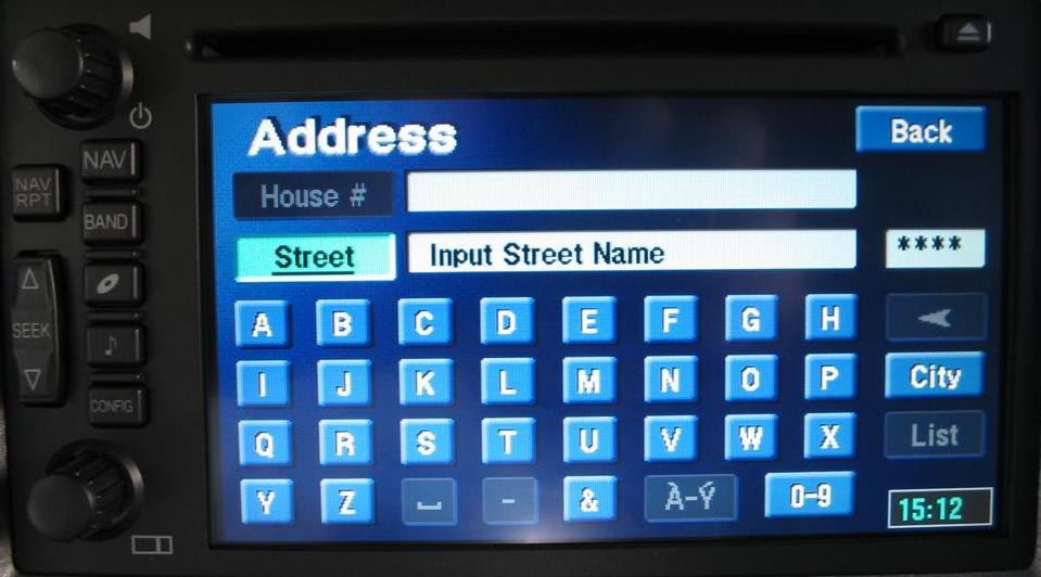

Great. You have a PM.
Happy Thanksgiving.
Got it. Looks great Klaus.

Well, the TNR was delivered! They shipped it overnight.
Time to take the truck apart again this weekend!
