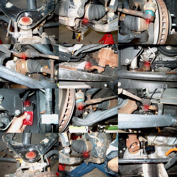

Hi,
How many lube points are there on an H2? I can only find 10 on our 2006, but some say that there are 11-16?
Who knows for sure? I can find the tie rod ends (2), upper ball joints (2), idler arm (1), pitman arm (1), tie rod ends (2), and center link (2). That is 10 in total.
Are there any that I missed?
By the way, you do NOT have to remove the skid plate to get to any of these. Just turn the wheels to move the center link to either side. You also do NOT need a swivel lube fitting. Straight one work fine, as long as they are mounted on a flexible lube hose.
Help!

This was sent before by some member. It should help

Thanks, but this diagram is not useful.
It shows 11 lube points, plus a 12th nonsense shot.
So where is the 11th zerk?
