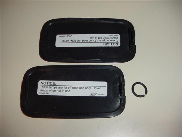

AND YET A NEW PROBLEM!!!!!!
The covers have a rubber "O" ring on the snap to hold them on. One of them broke the other is cracked! Already?? Now I can't put the covers on. It is illegal here to drive on public roads with the covers off! I guess I need duck tape!What a Shi>>ty design. I hope they don't use them on the shuttle!
