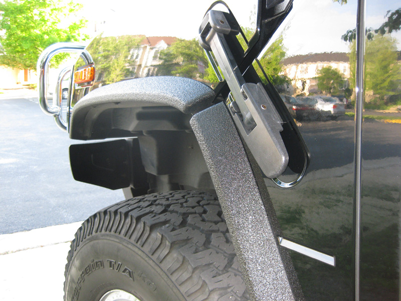

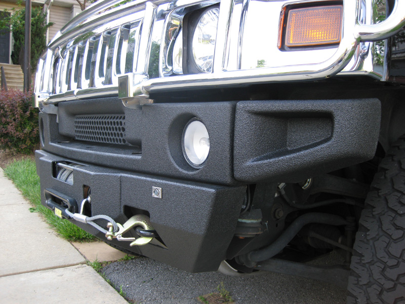

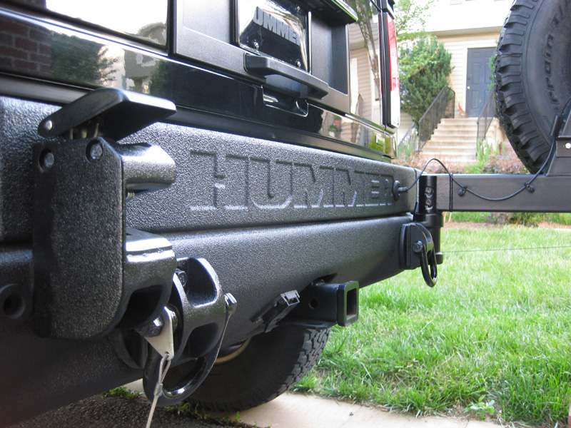

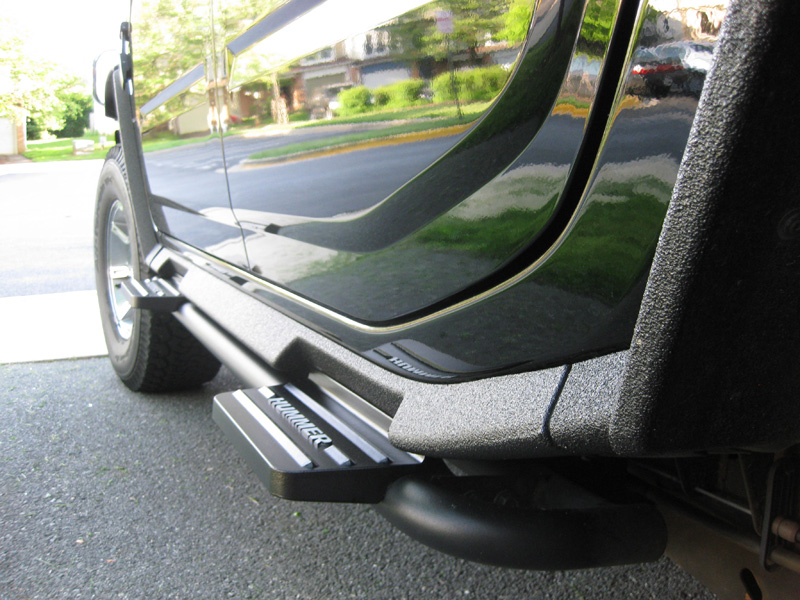

Take them off and gett'em Line-Xed.
Cost me about $600 to do the front bumper (plastic and metal), fender flares, the bits on the side below the doors, and the rear bumper.
That looks awesome. Worth the $600. Does the lineX fade at all? how about chipping on the front metal bumper?

There's two kinds of Line-X they had...one was the 'standard' which is what I had done. It has dulled ever so slightly to the normal, stock look...how it looked when the vehicle was new.
There was also a premium Line-X which is guaranteed to maintain a higher gloss...and they can color match this to any paint color. It would have been $150 more, but I liked the slightly dull 'new' stock look.
It's been over a year and about 20,000 miles (on and off road...and a road trip from Maryland to Maine) not a single chip on it anywhere. That stuff is TOUGH!
Yeah...$600 seemed like a good deal at the time...now I think it was a GREAT deal. Keep in mind that I removed all the parts myself, transported them, and put them back on...so I only paid for the Line-X to coat them.

Originally Posted by Cazador
The line-x looks effin amazing! Nice!
How was the fit when you re-attached the bits n pieces? Did having them coated effect the way they lined up with anything?
I may have to drop by the line-x dealer and have a talk about this.
The fit was tight on some parts...especially on the sections where the fender flares overlap, or tuck under, the bit below the door (running board?). When I took it to the Line-X shop they asked me to lay the pieces out so they could see how they went together and where they overlapped so they knew what to coat and what not to coat.
On some of the pieces that attach with the push-in clips/buttons I had to open the whole back up a little with a large drill bit...but all in all it snapped back together very nicely.
Beauty of the whole thing is that everything matches...I got the whole idea when I bought the sides steps. They came with the replacement 'running boards' that have the notches cut out for your foot...but the running boards were not textured like the stock pieces; the new ones were actually meant to be painted to match the body color...so I thought 'what would make them all match AND be rugged as hell?' -- Line-X!
