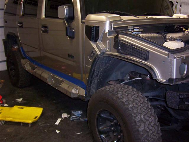

Angry Iron now has my valance done and the rock sliders are a trip from the powder coater from being done......
Check it out....

They are a bit over intrusive (gaudy) and to much $$ IMHO, but for a 1 off thats expected I guess.

These are work in progress pictures. Yes the ends will taper to meet with the plastic trim and will be closed.They attach at the frame to the original Factory rock tube mount holes. I did not want to attach to both body and frame then you get into alot of flex issuses. They will make contact with the body of the truck at the seam under the truck wear the Rocker panel is spot welded and will have rubber bump pads.This will limit any up travel of the RPP when the weight of the truck is resting on the RPP. There are large holes in the bottom of the panels for easy instalation of the upper mount holes and dranage/cleaning.

Will the final product have end caps or will they be open through the center? It looks like they are open and than would colloect mud, sand, snow and everything else.
They look sturdy enough to where it would take some MAJOR bashing to knock them out of form.
how do they attach to the frame/ body?

The tape protecting the paint is covering the door gap so it is miss leading there will be a good 1.5" clearence between the top edge of the slider and the door. These things are very well gusseted for strength so Ed will have to be doing some major thrashing on his ride to damage them. If he deforms this Rocker Panel protection. He will have more major damage than not being able to open his door.

Picture is a little misleading.... Final mount will not be that close..... Angle is such that we hope we bounce off rather than "deform"...
But we're anxious to see how they perform!!!
