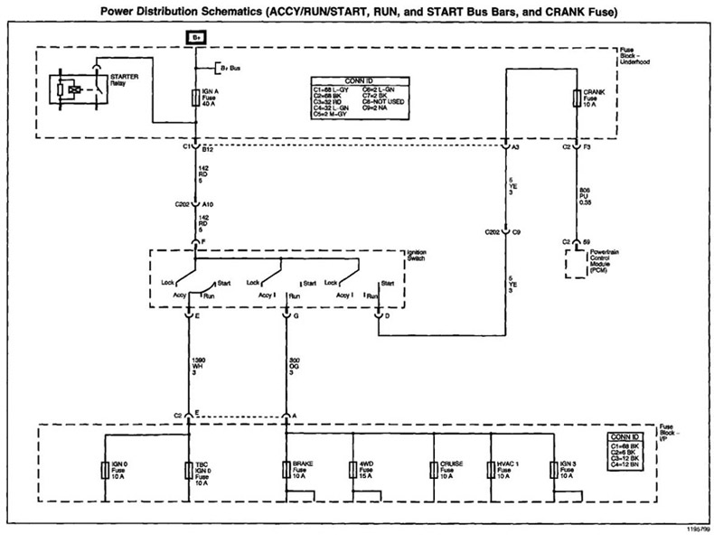

My problem is that "ignition fuse #0" keeps blowing. It happened a couple of years ago first. Now its happened again but whenever I put a new one in it pops.
Before I found this problem , I have replaced the key switch and the key cylinder.
Where does this ignition 0 fuse go to? It is on end of dash panel and is 20 amps. Thank you, doug

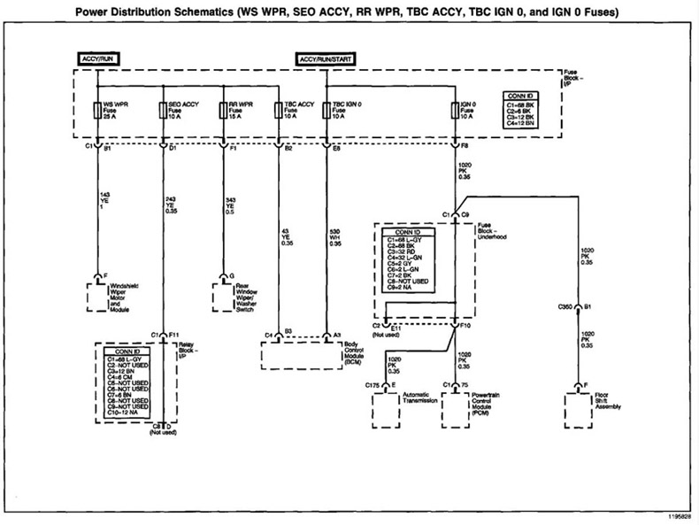

You didnt say what year, so I'm going off my 04.
Your 1st problem is you have a 20 amp fuse in a 10 amp circuit. I'm assuming that is what has gotten you by for the last couple years. Never eliminated the problem, just doubled the circuits breaking point.

HEy thank you very much! I Will study it. Your right it is a 10amp. It is a 2003.
